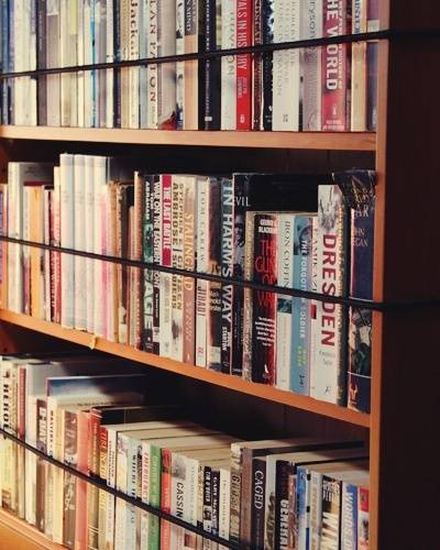

i am making a custom size card box filled with stuff that i want to put on top of a shelf (the box is bigger than the shelf), assuming the weight of the object is distributed evenly in the card box, what percentage of the box surface area (bottom of the box) that i need to have on the surface of the shelf, and the percentage that i can have floating by the edge of the shelf for the card box to not fall down.

Agreed. At the very least, I would use a thin rope to secure the box once it is on the shelf. Kind of like a variation of the securing bands in this picture:
https://s-media-cache-ak0.pinimg.com/736x/1c/16/70/1c1670afb724c26972c41df3334fe0e9.jpg
