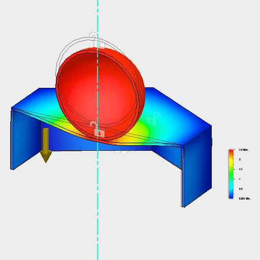

Very dumb classic mechanics question here:
The other day I caught sight of a trivial objects arrangement: a basketball placed on top of a 6-sided cardboard box on the floor, and I wondered how the weight of the hollowed sphere could cause bending on the supported, flat top surface of the box. However, despite having studied physics in undergrad, I could not work out the mechanisms involved: 1) Could time be a contributing factor to the bending (i.e, the box gradually cave in over time) or if the surface fails to bend at t0, it won't ever bend? 2) does bending depend on the top surface area of the box, e.g., whether increasing/decreasing the top surface area 100x while maintaining the same four sides would make a difference? 3) how does the material (e.g., rigidity) and weight of either the basketball (~700g) or the cardboard box factor into the their opposing forces and latter's bending?
Any intuition or explanatory equation is much appreciated!

OK. We engineers solve beam and plate bending problems all the time. As @SergioPL indicated, the deformations in these structures are determined by applying the 3D version of Hooke's law in conjunction with the stress equilibrium equation. For a plate like the lid of a box, the lid is in a state of "plane stress," in which the stress in the thickness direction is much smaller than the stresses in the horizontal direction. Get yourself a book on Strength of Materials, which goes into detail on how to solve beam and plate problems.

This is related to the yield behavior of the material. Once the lid deforms beyond the elastic limit of the material, it experiences the phenomenon of yield which prevents it from returning to its original shape.
Heavy ball made from rigid material on flexible box . Static analysis .
Was this FEM calculation from a membrane model, a plate model, or a 3D model?
Pretty impressive!
It is a 3D model .
