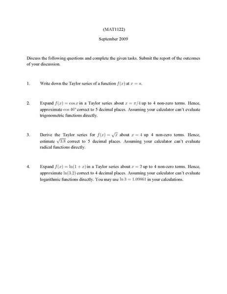

Hi,
My lecture had gave a project about analyzing and discussion about - Taylor Series.
I had done some research and tried understand and solve the question, but I'm in trouble now.
I could only complete No.1 and No.2 (don't know whether is correct or not), I stuck at No.3 I have no idea how to continue, No.4 too. could someone please help me?

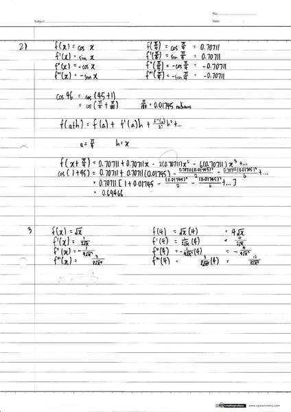

You are evaluating the function in (3) incorrectly. You have
[tex]f(x)= \sqrt{x}[/tex] [tex]f(4)= \sqrt{x} 4= 4\sqrt{x}[/tex]
Are you multiplying by 4? [itex]f(4)= \sqrt{4}= 2[/itex].
Similarly, since
[tex]f'(x)= \frac{1}{2\sqrt{x}}[/tex], [tex]f'(4)= \frac{1}{2\sqrt{4}}= \frac{1}{4}[/tex]
In my opinion, for (2) you would be better off writing the exact value [itex]\sqrt{2}/2[/itex] than the approximate "0.70711".
Thanks for your reply. I had changed number back to fraction. The answer is more accurate. I had done number 4 as well. I have no idea with number 3, I don't know what to do with the square root. Besides, i would like to ask when differentiate cos X = -sin X thn how a bout -sin X? isn't become -cos X? in differentiation table does not have "-sin X"
Can you be clearer on what you're asking? Your function is f(x) = x1/2. f'(x) = (1/2)x-1/2, and so on. It's probably easier to calculate your derivatives using exponent notation rather than using radicals. For this problem you need to estimate f(3.8) = f(4 + (-.2)), using a formula similar to what you show in #2.
All you need to know for this problem are three rules:
  1. d/dx(sin x) = cos x
  2. d/dx(cos x) = -sin x
  3. d/dx(k f(x)) = k d/dx(f(x))
The third rule can be used when k = -1.
Thanks. now I just want to ask about Number 3. I don't know how to start with the "square root".
The first part of my reply was about #3. What part of it don't you understand? [itex]\sqrt{x} = x^{1/2}[/itex]
