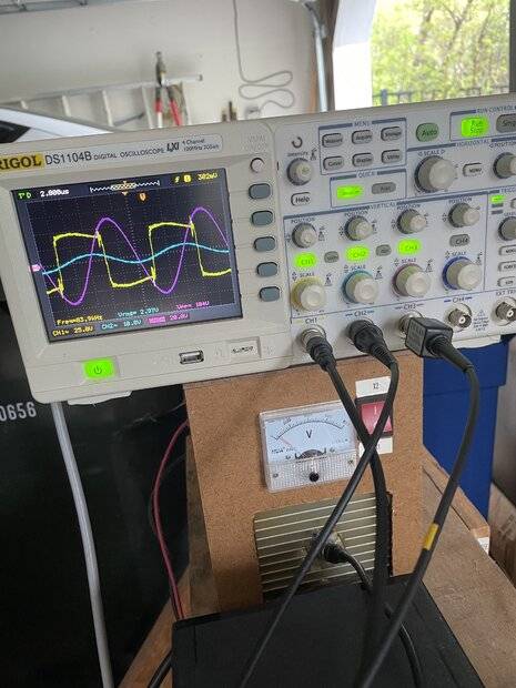

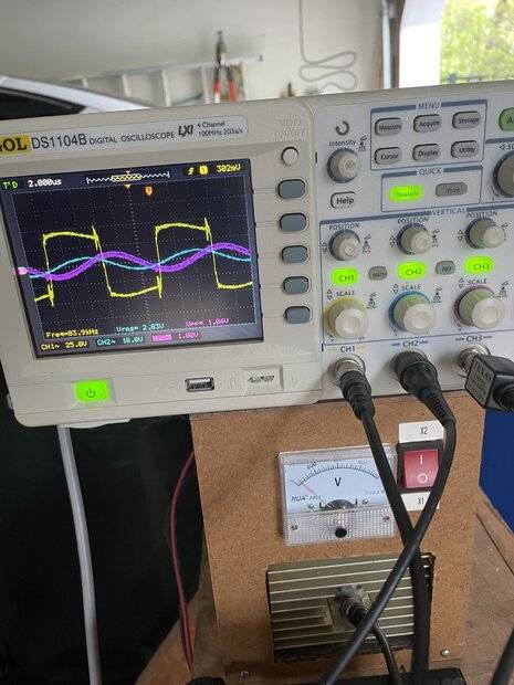

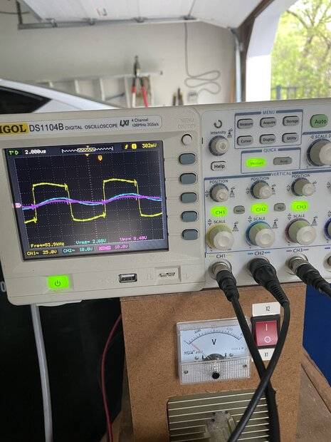

I am referencing the pink waveform which is the capacitor voltage (value shown a screen bottom is peak-peak).
Wave 1 is a standard probe across the capacitor. Signal is 90 degrees lagging the blue current waveform. 104v peak-peak
Wave 2 is a standard probe across a 1:100 resistive divider. 1.04v peak to peak
Wave 3 is making same measurement across resistive divider using differential probe. Note that the voltage is close to mirroring the current waveform. The voltage (8.04v) and phase are completely wrong.
I know that the noise is my current waveform. The differential probe and/or power supply are picking it up. All my leads are twisted to reduce stray inductance. The positioning of my scope and leads are identical between waves 1&2 vs wave 3. The only difference is using a standard probe vs the differential probe.
Is my probe bad?
