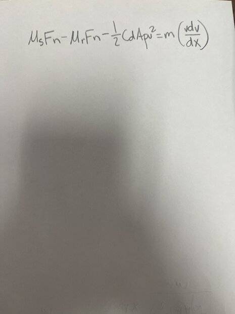

Hello! This is a combination of physics and calculus. I have a non constant drag force I’m trying to integrate in relation to velocity and position. I’ve started it, however I’m getting stuck on the separating and integrating. I’ve tired moving equations over to different sides however it’s just not working. I’m trying to get v to the right side and dx and m to the left. Everything besides the position (x) are known constants
See pic below.

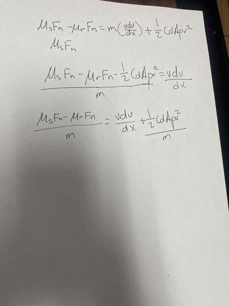

Tried a few approaches but all became very complex and couldn’t separate the dx from dv
solve for dv/dx and integrate with respect to x.

I may have forgot to add that v isn't a single constant. it is changing from 120 to 0 which will be the bounds for the right side But ∆x is what I'm solving for in the end
which is why you should integrate.

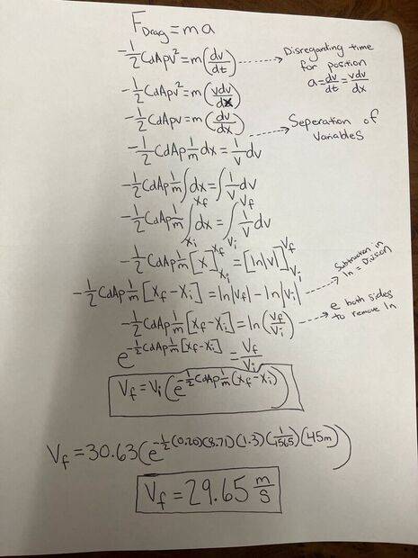

Its similar to what I am doing here. But, there is now two additional forces in additon to the drag force but only the drag force is non constant both the usFN and urFN are just constants
I'm not sure
It will take me some time but from what I am seeing, after integrating you want to solve for ##x_f-x_i##, is that correct?
yes correct!

Your equation is of the form:
$$ \varphi - \beta v^2 = m v\frac{dv}{dx}$$
Where ##\varphi## is a constant.
Make the substitution ## u = \varphi - \beta v^2##, and differentiate ##u## w.r.t. ##x##.
Show us what you get.

That is obvious, as your equation includes the derivative ##\frac{dv}{dx}##.
Also, most of the images you've posted are of poor quality due to bad lighting. This is one of the main reasons we ask members to post using LaTeX rather than images of hand-written work.
It's not that difficult to use the version of LaTeX that is supported on this site. The equation you wrote in post #1 of this thread is
$$\mu_sF_n - \mu_rF_n = mv\frac{dv}{dx} + \frac 1 2 Cd Apv^2$$
This is how what you wrote appears to me.
The code I wrote is $$\mu_sF_n - \mu_rF_n = mv\frac{dv}{dx} + \frac 1 2 Cd Apv^2$$.
