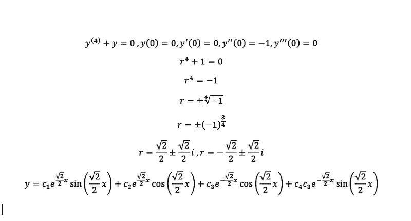

##y^{(4)} + y = 0, y(0)=0, y'(0)=0,y''(0)=-1,y'''(0)=0##
My issue with this equation is not with the steps, I don't believe but the solving of the IVP, the derivatives of my solution end up being close to 32 terms long, and I was wondering if there is any shorter method I could use without having to figure out the close to 50 terms for all 3 derivatives combined.
(ignore the ##c_3## next to my ##c_4## term, that was a typo)
You can always plug it back in and show with pencil and paper that the solution satisfies the original diff eq and all the initial conditions.
Combine terms as you go along and look for patterns. For example, consider the terms ##f(x) = c_1 e^{ax}\cos ax + c_2 e^{ax}\sin ax##. First, factor the exponential out so you only have to do the product rule once. When you differentiate, you get
\begin{align*}
f'(x) &= a e^{ax}(c_1 \cos ax + c_2\sin ax) + e^{ax}(-a c_1 \sin ax + a c_2 \cos ax) \\
&= a e^{ax} [(c_1+c_2)\cos ax + (c_2-c_1)\sin ax].
\end{align*} Note that this is essentially the same form you started with, so you can easily write down the second derivative without much effort:
\begin{align*}
f''(x) &= a^2 e^{ax} [((c_1+c_2)+(c_2-c_1)) \cos ax + ((c_2-c_1)-(c_1+c_2))\sin ax] \\
&= a^2 e^{ax} [2c_2 \cos ax - 2c_1 \sin ax] \\
&= 2 a^2 e^{ax} [c_2 \cos ax - c_1 \sin ax]
\end{align*} So in comparison to f(x), differentiating twice produced an overall factor of ##2a^2##, changed ##\sin x## into ##\cos x##, and changed ##\cos x## into ##{-\sin x}##. You should be able to convince yourself that ##f''''(x) = -4a^4 e^{ax}(c_1 \cos ax + c_2 \sin ax)##.
