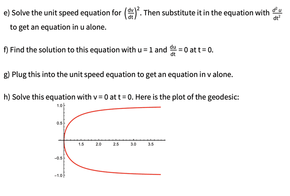

Hi all, if anyone could help me solve this 2nd order differential equation, it would mean a lot.
Problem:
Solve the equation with y = 1, y' = 0 at t = 0
y'' - ((y')^2)/y + (2(y')^2)/y^2 - ((y')^4)/y^4 = 0
I have never solved an ODE of this kind before and I am not sure where to start. Wolfram and Symbolab calculators will not give an answer.
Thank you.

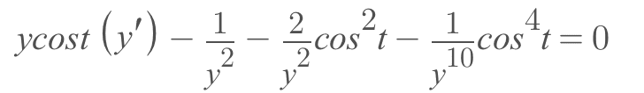

I am sorry all, my original post included a bad typo in the equation. I am not experienced at typing equations into the computer.

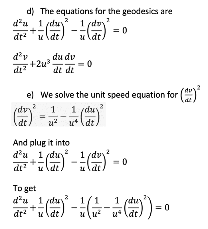

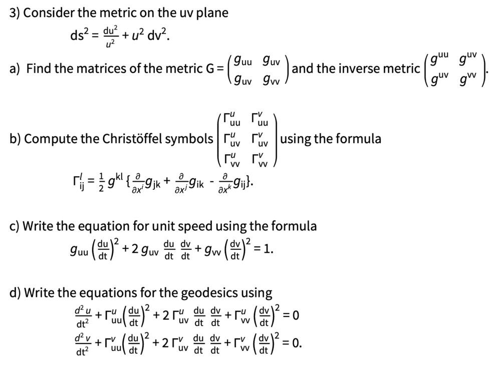

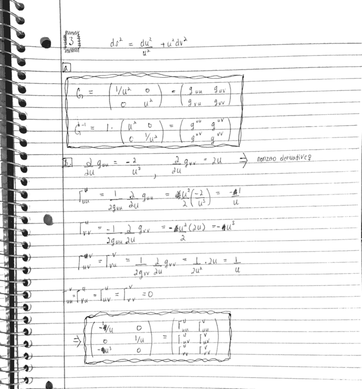

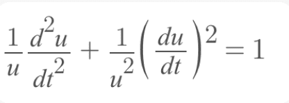

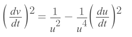

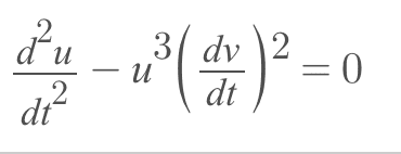

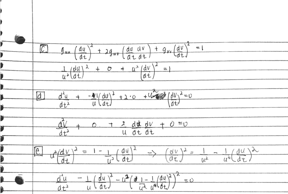

Here is the entire question and my work leading up to the differential equation in part (f.) The professor warned us ahead of time the ODE for the geodesic may be difficult.
I believe the last line is the correct ODE to solve for, which I was unable to solve using any methods I was familiar with. Looking at the plot of the geodesic, it looks like the V component asymptotically approaches 1 and -1 at infinite and -infinite t. the U component only exists for > 0 and is also symmetric around t = 0. Does anyone know of any similar ODE examples to learn from?

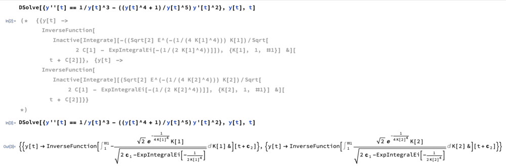

After doing the substitutions we ended up with the following equation
where t = θ and u = y.
The 1st order ODE could not be solved by using Symbolab. Is there a mistake??

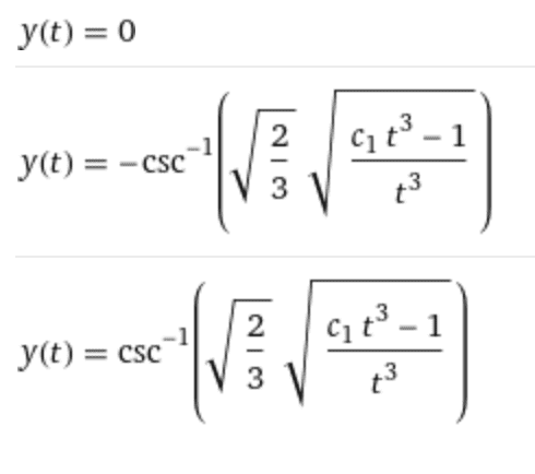

whose solutions are
where y(t) has been replaced with Θ(x) and t with x.

Defining a different y from what we had earlier is confusing.
At t=0, u=x=1, ##y=\dot u=0##, ##\cos(\theta)=0, |\csc(\theta)|=1##.
I get ##(\dot u)^2=\frac{2u^5-2u^2}{5u^3-2}##, leading to a nasty-looking integral.

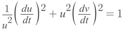

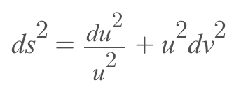

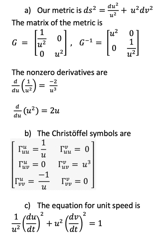

Is anyone familiar with the surface corresponding to our metric
It could give us an idea of what the geodesic is.
It looks like the surface stretches the du vector to infinity at u = 0 and shortens the dv vector to 0 at u = 0.

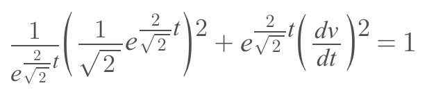

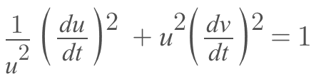

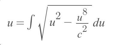

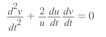

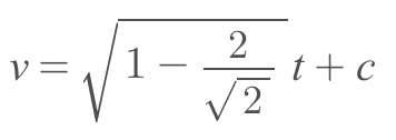

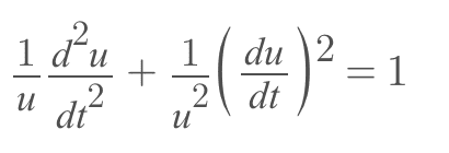

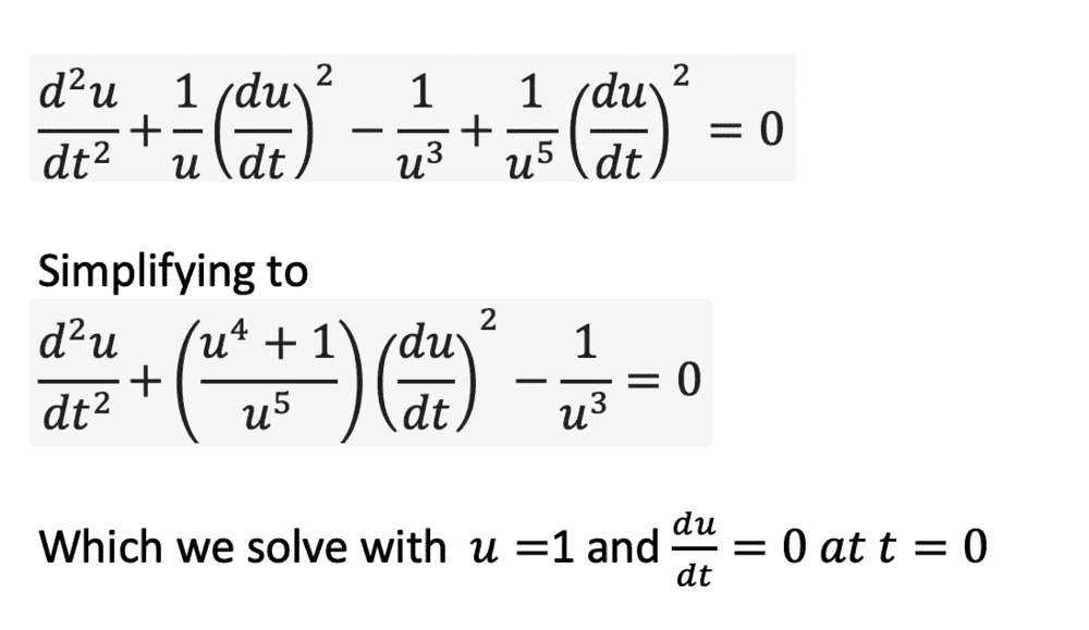

Dear all,
There is another error in our differential equation.
Starting over from part e) we solve the following equation for (dv/dt)2.
giving
and substitute it in the following equation
giving

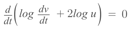

Which offers no clear way to solve. We examine the following expression from part d).
which makes
which implies
for some constant c. solving,
substitute into the first equation to get
which makes
I think this way is not easy.
The expression
has the solution
and

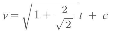

For the v component of the geodesic, we plug in
into the unit speed equation
giving
and
We then integrate to give
and
which is incorrect judging from the following plot in the uv plane
but I think we are getting closer to the correct solution.
