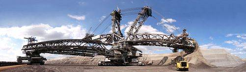

Does this qualify?
http://en.wikipedia.org/wiki/Bagger_288
That is certainly capable of hunting down and eating things...
http://www.slideshare.net/Bryagh/where-is-my-bulldozer
See slide 14/28
You could double it's linear dimensions but;
it would cost 2^2 = 4 times as much to paint and
it would weigh 2^3 = 8 times as more and
it would cost 2^3 = 8 times as much to build.
