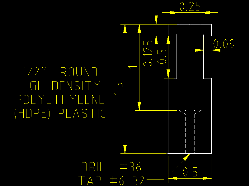

I'm probably going to change my design into this design:
The metal slug will be resting at the bottom, where the 1" is marked. The indent that is .5" high will hold the magnet wire.
So, in effect, I'm not looking to move it much. (around .5 inch) I'm actually going to attach magnets to the top of the shaft, however, so that when a current is run through the wire, it repels the magnet and the shaft is propelled out of the solenoid casing. (I'm not sure if that would work, what's your opinion on it?)
No, a solenoid works by drawing a ferrous "armature" into the coil, not by repelling a magnet. The bar gets pulled into the area of the coil that has the highest magnetic field density. So you start with the bar/armature only partly in the coil, and when you apply the current, that pulls the bar all the way into the coil. That was explained in the document that I linked for you.
