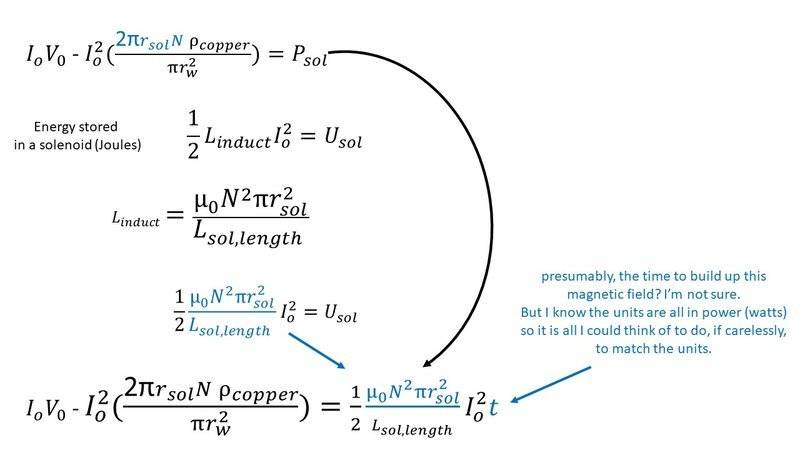

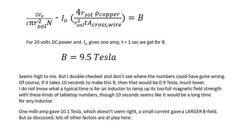

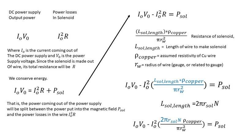

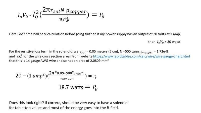

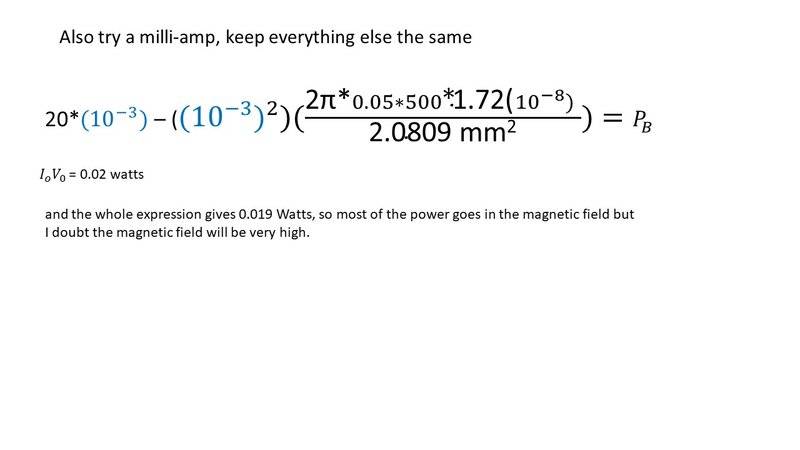

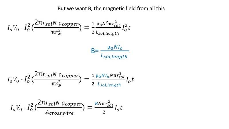

For the calculation of B field in Tesla for wire and power supply values (N turns, DC power supply current and voltage output, type of AWG wire), I attached JPEGs of a powerpoint I used to do the calculations. Its easier for me that way since powerpoint still has an equation editor. Let me know if my calculations seem right, close, or even just a long way off. I admit I could not find any easy expression for the power (watts) at which a solenoind ramps up to its magnetic field.
The blue color fonts in the attached jpegs represent algebra changes as I move from one expression to the next.
