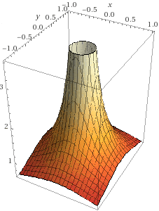

Finally, a 3D plot looks good, with ##R## and ##\frac{Q}{4\pi} = 1##.
However, the electric field seems to die off really fast.
I am now wondering if I can take this result and create a cylindrical shell of charge.

Sorry. Apparently the approximation ##\frac{\sqrt{2}}{\pi} = \frac{1}{2}## fails near the radius of the ring. That's why the electric field becomes super negative on the 3D plot around the outer edge. I didn't think that tiny approximation would produce such a serious affect on the fields. The original solution presented in the paper seems to work very well, even though it's kind of ugly to look at ... I shouldn't have messed with it.
Here's what it should look like. All credit goes to the person in the paper, who is much smarter than I. Excellent work. I wish I could have solved it.
