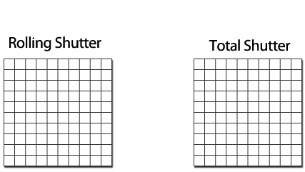

It does look very much like a flicker from fluorescent lighting caused by rolling shutter. This is a well known issue with CMOS cameras. With rolling shutter there is a wave going down through the sensor which removes reset from the pixels, enabling them to accumulate charges, followed by another wave during which the charges are sampled. Distance between waves varies with exposure but the speed is determined by data transfer rate and is usually constant.
Many sensors (like those in mobile phones) have built-in flicker detection and cancellation option in the op-chip processor. Some have explicit 50/60Hz flicker frequency setting, although it may be difficult to get to through the UI of whatever device you are using.
You can try fiddling with exposure, frame rate etc if you can, you might hit a combination where flicker is less pronounced, although image quality might not be ideal.
If you are dealing with continuous video feed and the background is mostly static, you might be able to extract flicker waveform from a series of consecutive frames but it is not going to be easy.

Common solution involves setting the exposure in either 1/100 or 1/120 increments (depending on which country you are in), this way each pixel is exposed for integer number of half-periods. As I said, some cameras do that automatically, some have manual setting but it may not be easy to get to.
But flicker is not the worst of it If there is any motion in the scene (either the object or the camera), you get corresponding geometric distortions, which can be quite severe for fast moving objects. And pretty much nothing can be done about it.

It is a combination of both. The light flickers and the camera exposes different scanlines at different times.
http://www.diyphotography.net/everything-you-wanted-to-know-about-rolling-shutter/
