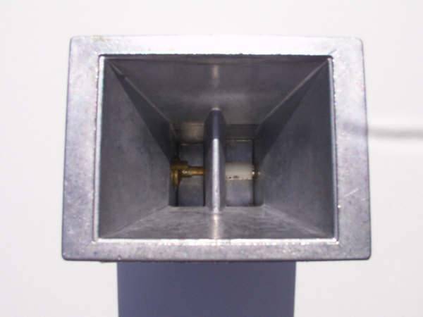

that receiver is just a microwave diode in a cavity and the meter is connected across the diode
depending on the frequency, and that feed horn looks to be around 10GHz ( you can confirm)
if it is around 10GHz the diode is commonly a 1N23, 1N415E or similar. The diode rectifies the incoming microwave signal and generates a DC current to the meter
cool stuff to play with ... I play on many microwave amateur radio bands from 2GHz to 24GHz
in the pic below is a simple transmitter / receiver cavity for 10 GHz from my collection
on the left is the tiny GUNN diode for TX and on the right the larger white barrelled 1N23 receive diode

Thank you Dave. But I still don't understand how the diode convert microwave signal to DC current. What type of diode is it? Isn't there supposed to be something like a dipole antenna inside and the diode then will rectify the AC current to DC? Won't only one diode produce a half-wave output?

They are usually point contact or Schottky barrier diodes
here's a little on Schottky Barrier diodes ...
A Schottky barrier diode (SBD) consists of a rectifying metal-semiconductor barrier typically formed by deposition of a metal layer on a semiconductor. The SBD functions in a similar manner to the antiquated point contact diode and the slower-response pn-junction diode, and is used for signal mixing and detection. The point contact diode consists of a metal whisker in contact with a semiconductor, forming a rectifying junction. The SBD is more rugged and reliable than the point contact diode. The SBD's main advantage over pn diodes is the absence of minority carriers, which limit the response speed in switching applications and the high-frequency performance in mixing and detection applications. SBDs are zero-bias detectors. Frequencies to 40 GHz are available with silicon SBDs, and GaAs SBDs are used for higher-frequency applications.
SataSata said:
...there supposed to be something like a dipole antenna inside and the diode then will rectify the AC current to DC?
no, a dipole isn't used, in some cases a monopole antenna is used but that isn't even needed in this situation
I'm not up enough on semiconductor theory to speak about the interaction of the EM wave and the diode and how a current is produced, someone else may be able to answer that ... I did do some goggling after I posted my first response but didn't find any decent explanations Schottky barrier diodes
