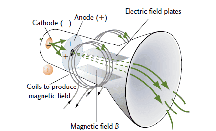

A cathode-ray tube aims electrons parallel to a nearby wire that carries current in the same direction. What will happen to the cathode rays in terms of deflection?
[/B]The Motor force deflects the cathode rays ?

Your picture doesn't match the question (coil versus parallel wire). Can you please check that?
Sorry. Then let's say a steady beam of electrons move parallel to the wire carrying current. Then what happens? Thanks
Yeah, that matches your problem statement better. :-)
So what do you think? Think about the right hand rule -- what does the B-field look like around the wire? And again use the right hand rule to figure out the Lorentz force on the e-beam from that B-field. Are you familiar with the vector force equation Lorentz force?
The B-field meets 90 degrees to the electron. I am not familiar with lorentz force.
