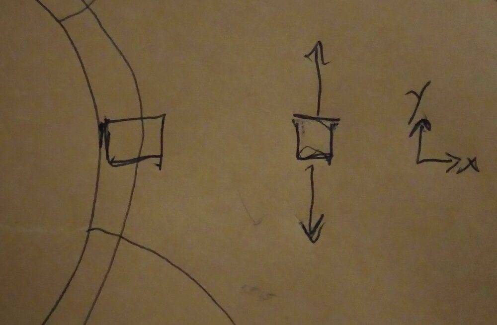

Wouldn't there be no shear stress on surface normal to the cylinder? This is what I would imagine the internal stress adjacent to the hole would be:
Because the surface tangential to the hole can't exert any stress ##\sigma_x=0## and ##\tau_{xy}=0##. This would mean there's uniaxial tension. This would also mean the shear stress normal to the cylinder would also be 0, but shear stresses at an angle would be nonzero.

Who said anything about a "hole?" A hole is not a solid cylinder.
The deformation of a solid is much more like the flow of a viscous fluid in the limit of negligible inertial effects (slow flow) than that of an inviscid fluid. And certainly there is a major difference in behavior between viscous fluids and inviscid fluids in this limit.
For inviscid flow, your hypothesis is bogus because the stress tensor, as I said, is isotropic. It doesn't even work for the simplest viscous flow of shear between two infinite parallel plates, where the principal directions of stress are at 45 degrees to the streamlines. And, for the simple case of a Hookean solid being sheared between two infinite parallel plates, the principal stresses are also at 45 degrees to the direction of shear. So, in short, your hypothesis is totally bogus.
