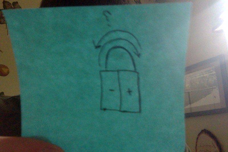

How does a battery charge while it is operating? Just out of curiosity. I cannot figure out how this could possibly work if charge must travel from anode to cathode in order to operate the device, but must travel the opposite direction in order to recharge.

Can you doodle us a circuit to show what you are describing?
If recharging means simply reversing the current, how can the cell send charge through the device simultaneously?
It does not. The charger takes care of that. The battery is like an additional load (and the charger keeps it above the voltage it would supply).
