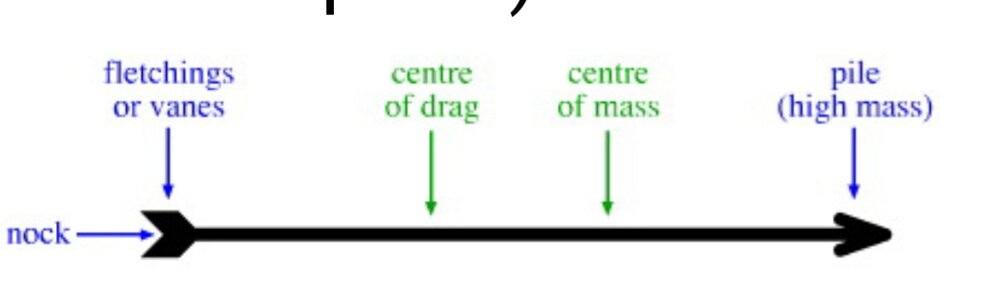

Now we also believe arrows have two axis points, the front point is called the centre of mass, the rear the centre of drag
My question is how can I find the front axis
Some in archery feel you can pinch the arrow between two fingers then tap the arrow on a hard surface and then pay attention to the vibration in the shaft. Moving the pinch left and right a little at a time until you find the location of the longest vibration
So if anyone could help with this I'm all ears

Here is an image
Jrat said:
Here is an image
So if you rest the arrow on your finger at what you call the center of mass in the image will the arrow balance on your finger? It's a yes or no answer.

I believe that the locations of the center of mass, the center of drag and the natural vibration nodes of the arrow are not related.
Stroking the arrow creates longitudinal vibrations in the rod, which are waves that travel along the length of the rod.
The waves travel to the ends of the rod and are reflected back and forth between both ends.
On their way back, they collide in a head on collision with other waves traveling in the opposite direction, cancelling each other and creating those nodes or points if minimum deflection that your fingers can detect.
Please, see this explanation about the vibration modes of a rod:
http://hyperphysics.phy-astr.gsu.edu/hbase/Music/barres.html#c3
The location of the center of mass does not move sideways during the flight, it must describe a more or less parabolic trajectory.
The arrow, however, can oscillate around that imaginary center as much as it has to; therefore, at some points on the flight trajectory, the center of mass may be located way out of the physical rod (think of the location of the center of mass of a donut).
The center of drag only exists when the arrow is flying and fighting the aerodynamic resistance of the air; hence, its location is purely geometrical and aerodynamical and has nothing to do with the location of the nodes of the vibrating frequencies of the arrow, other than some additional damping of the vibration.
Since the center of mass is always above the supporting edge, finding its location is not always easy by simply supporting the arrow.
For a fine location of the center of mass, you could built a rig more or less similar to this one:
https://www.rcuniverse.com/forum/tips-techniques-180/708060-vanessa-c-g-rig-how.html
