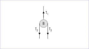

I think it is useful if you think in terms of free body diagrams like the one below.
Think of this upside down (I couldn't find a better picture) and ##T_1## is the weight you are trying to lift and ##T_2## is the tension in the cable. In here ##T_2 = T_1/2## (otherwise you have an imalance) so the force on the rope is half that of the weight.
It is explained here
