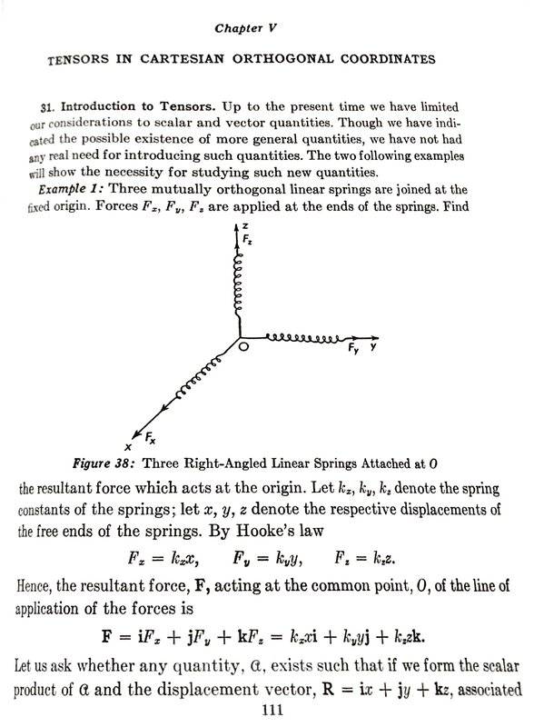

Another thing I've seen attached to moment of inertia is the word tensor, and the moment of inertia tensor. As far as I know a tensor, according to a books that I have, is a linear operator that maps a vector to something else, a first order tensor mapping a vector to a scalar, a second order mapping a vector to a vector, and a third order tensor mapping a vector to whatever that is that comes after vectors.
Another book gives a different kind of introduction:
Which is admittedly confusing.
You don't really need tensors if you have never seen them to understand this. In Cartesian coordinates, an element of mass is ##dm=\rho dV=\rho dx~dy~dz##. Its contribution to the moment of inertia would be ##dI=dm(x^2+y^2+z^2)=\rho(x^2+y^2+z^2)dx~dy~dz##. The total moment of inertia is the sum, actually integral, of all such contributions. Since there is mass in all three directions, you need to do three additions, one per direction. Similarly for other coordinates but Cartesian is the easiest to visualize because all three directions are equivalent. Of course the moment of inertia does not depend on the choice of coordinate axes that one uses to do the integrals in.
