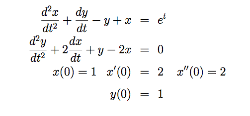

Hi, have this strange 2nd order ODE in one of my tutorials that I am struggling to start. I am not used to dealing with derivatives of both x and y as well as a function involving t.
I was wondering if anyone may be able to point me to the starting line.
I am trying to convert them into 1st order ODEs.
Thanks

Do you mean convert those two second order equations to four first order equations? There is no way to reduce a single second order equation to a single first order equation or two second order equations to two first order equations unless you have additional information such as already knowing a solution.
The standard method would be to define new variables, say z1, z2, z3, and z4 such that z1=x, z2= dx/dt, z3= y, and z4= dy/dt. Of course, [itex]d^2x/dt^2= d(dx/dt)dt= dz2/dt[/itex] and [itex]d^2y/dt^2= d(dy/dt)/dt= dz4/dt[/itex].
The equation [itex]d^2x/dt^2+ dy/dt- y+ x= e^t[/itex] becomes [itex]dz2/dt+ z4- z3+ z1= e^t[/itex] or [itex]dz2/dt= -z1+ z3- z4+ e^t[/itex] and [itex]d^2y/dt^2+ 2dx/dt+ y- 2x= 0[/itex] becomes [itex]dz4/dt+ 2z2+ z3- 2z1= 0[/itex] or [itex]dz4/dt= 2z1- 2z2- z3[/itex].
The other two equations are, of course, [itex]dz1/dt= z2[/itex] and [itex]dz3/dt= z4[/itex].
