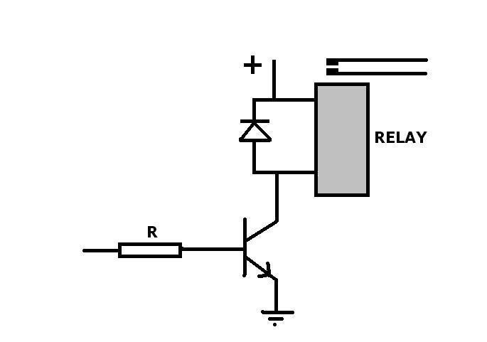

Hello, First let me say i am NOT an expert and have very little knowledge of electronics. I am able to solder and build simple circuits, but I don't have any training and I understand almost nothing about how electricity works.
I am looking for an electrical schematic. My goal is to turn a key on my computer keyboard on and off repeatedly at an adjustable rate (between 1-10 Hz.) I already have lead wires connected to the key, and it turns on and off correctly if I connect the wire leads.
Ideally, the power source for the circuit would be 5.2 volts from a USB plug, but I can get an external power source if that is not enough. So far, I have tried using a relay connected to an LM3909 LED flasher. Unfortunately, since this was designed to power an LED, there was not enough power to trip the relay.
Please let me know if you can direct me to any solutions on the web, such as premade schematics that could be easily adjusted for this.

The key is for a game I play and I would like to simulate repeated key tapping (I would like to avoid software solutions and would prefer to use hardware.)
I have tried several relays. The lowest power one I could find was a reed relay, 5 VDC, 20 miliamps for the coil. http://www.radioshack.com/product/index.jsp?productId=2062478"
The relay worked correctly when current was applied, however it didn't have enough power when I ran it through the oscillator chip.
Your IC is probably running out of drive. Buffer it with a transistor.

EDIT: Pursuant to what Phrak said, I found these as the second and third results when I googles for 'transistor as switch':
http://www.rason.org/Projects/transwit/transwit.htm
http://www.electronics-tutorials.ws/transistor/tran_4.html
This is a relay driver. (Click on it to make it bigger). Your oscillator chip's output would connect at the left of the resistor marked R.
This resistor would have a value of about 47000 ohms
Your switch would connect to the two relay contacts at the top of the relay.
The transistor would be any small NPN power transistor such as a BD139 although you would have to know the current drawn by the relay and its rated voltage. This may be written on the body of the relay.
The diode across the relay is there to protect the transistor from high voltages generated in the relay. It should have a peak inverse rating that is high enough to do this. Diodes are cheap, so a 1000 V diode would be suitable.
A 1N4007 would be OK.
The keys on my keyboard repeat if I hold them down for about a quarter of a second. Would that be a suitable repeating rate for you?
If you go to START / CONTROL PANEL / KEYBOARD, there is a window there that let's you set the initial delay and the repeating rate if you just hold a key down. This is in Windows XP.
In any case, you would have to allow for it in case the relay holds the switch closed for any length of time and the computer considers that someone is holding the key down.
thanks vk6kro, I will look into this and see if it works
