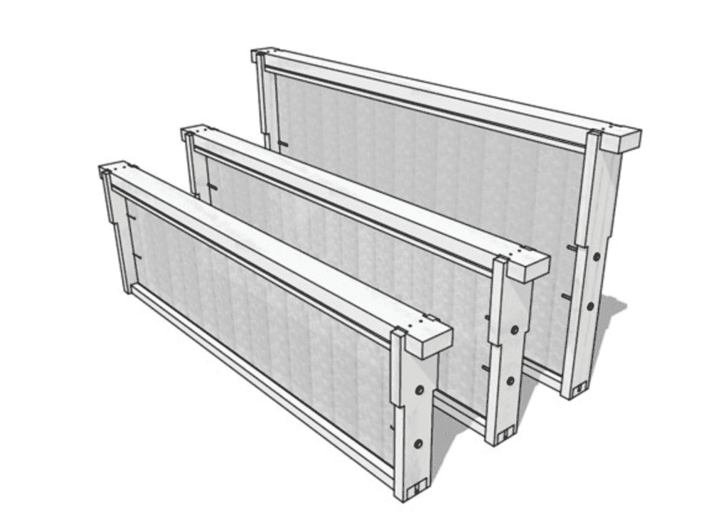

Need to heat 8-12 metal plates to 41C for 2 hours.
(In opening, hi. I'm a lawyer, not a physicist, and I'm entirely out of my depth here.)
I need to make roughly 8 wooden frames (19 inches x 1-1/16 inches x 9-1/8 inches). Into each, I'd like to place a thin metal plate with hexagonal cells (5.27 mm cell diameter) pressed into them. I need to heat these cells (or, more specifically, what will be the contents of these cells) to 41C and maintain that temperature for 2 hours. It needs to be *fairly* precise (+/- 2C, more or less) and something that can be repeated at 2 week (give or take) intervals.

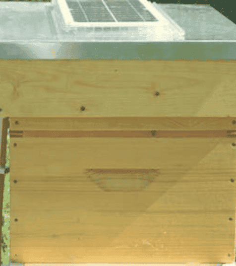

The frames/plates will be perpendicular to the ground and parallel to each other in a wooden box. No heating element (other than the plates, which will be coated in wax) can be exposed.
Heat source ideally needs to be above the frames/plates and must be fairly easy to lift off/remove. Solar would be workable or, failing that, something else that can safely be left outside.
So my question is, mostly...how do I heat these plates?

One problem is that the metal comb is arranged vertically so there will be a thermal gradient if you do not circulate the air to even out the heating. That suggests a warm air circulation system would be needed with the heat source at the bottom.
If the metal plates were double skinned they could be heated by warm water rising between the plates like in a counter flow heat exchanger, or a radiator. By keeping the circulation fast there would be less trouble with fighting stratification, to prevent formation of a thermal siphon.

I would opt for water heating. Google up 'liquid cooling plate' and 'hourglass tube radiator': those might give some ideas for the heating elements to be embedded in the frames. To keep them removable there are quick connect plugs/receivers for small water pipes.
The system should be filled up only during the heating period, and you should make it so that it drains down when the pump is off.
Temperature can be set and maintained within a water tank with conventional devices: you need only a decent pump to fill up the system and circulate the water.
