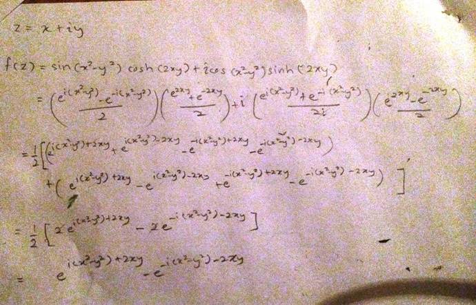

Hello! I am stuck at the final step. How do I get x+iy from the equation? Help!
I am so sorry for posting this question in a picture instead of writing it out, because I don't know how to write equations on here.

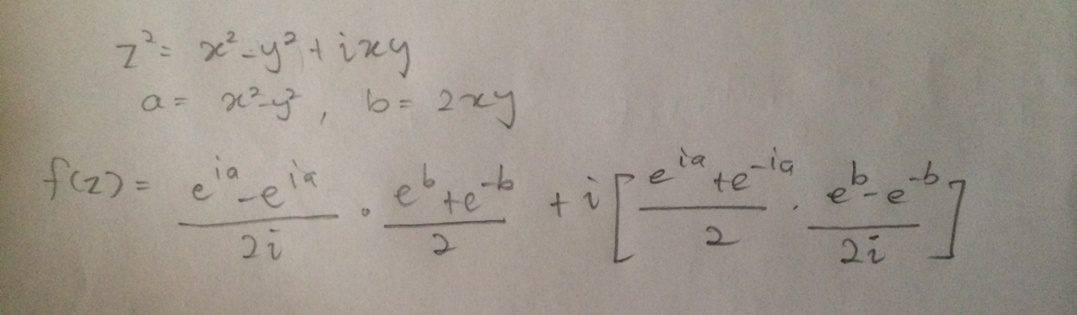

Thanks! This is a faster method than using exponentials. But if I were to use exponentials, how do I do it? I got stuck here, look.
