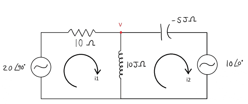

How can I find Voltage V in an AC circuit using loop rules?
5 replies · 2K views · last reply
MechEngrStdnt
AC circuit schematic with two loop currents i1 and i2 and node voltage V: a 20∠90° source with a 10 Ω resistor, a 10J Ω inductor down from node V, a -5J Ω capacitor, and a 10∠0° source on the right.
Need to find Voltage V. I know that I need to first solve for the currents, have tried using loop rules, not having much luck.
Just would like to know how to approach, and solve, this problem. ME and circuits has never been my friend, thanks!
