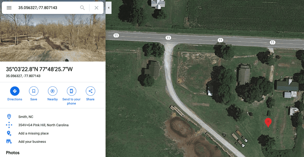

I was wondering how much rock there was above the water table, but since you don't give the surface RL of the well I thought I would try Google Earth. You appear to be giving station Lat/Long coordinates for wells in a regional mapping grid rather than in WGS84 = GPS, as used by Google Earth and SOLID. What grid are you using?
My SOLID is now working and seems to agree close enough with yours, give or take the couple of miles possible error in location.
No, those are WGS84 coordinates in decimal degrees. I've attached the Google map of Pink Hill station using the coordinates given on the previous image. The wells are the three dots to the east of the location symbol.
