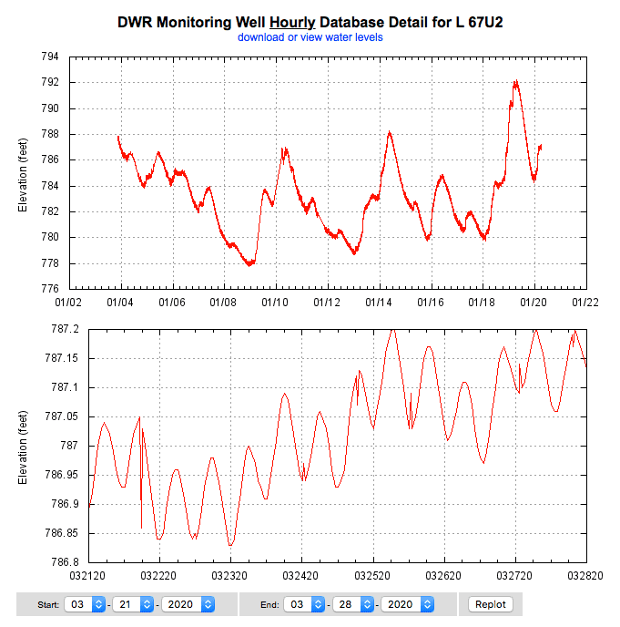

In my work with the North Carolina Division of Water Resources our measurements of water levels in monitoring wells (especially those in basement rock) commonly reveal Earth tides (https://www.ncwater.org/?page=20).
The data is collected hourly (using a pressure transducer) which is frequent enough to capture the curve shape and show the similarity to ocean tides, although at a much reduced amplitude. Water levels from our well called Troutman (L67U2) are displayed in the attached image.
The upper graph illustrates the complete record for this well and the water level responses due to evapotranspiration and rainfall. The lower graph shows a recent week of data and captures Earth tidal responses. This well is 354 feet deep and about 180 miles from the ocean.
We only give the public access to daily measurements from our wells, but we can honor special requests for hourly data. I've weighed into suggest that the original question might be answered by a locally monitored well with at least hourly water level measurements.

Wow. Very interesting. Thank you for sharing.gNat said:In my work with the North Carolina Division of Water Resources our measurements of water levels in monitoring wells (especially those in basement rock) commonly reveal Earth tides
There are several periods visible in the data. The 12 hour cycle shows roughly 4.5cm peak-to-peak deviation. I can't say if that is reasonable for an Earth tide. I can also speculate that tides change the stresses in the rocks that cause water in the cracks to move and thus force water into the wells. That would make a very sensitive instrument for tidal forces, but the water level would not directly indicate changes in elevation of the Earth's crust.
That data sounds ripe for a grad student to take on as a thesis project.

I am surprised that Earth Tide can be seen in the record. I would expect the Earth to rise and fall with the ground water. I am going to take some convincing.
In the bottom graph there is a minimum at midnight and noon every day. There seems to be no daily phase shift like a tide, so I would hazard a guess that it was due to the rate of discharge from the well, which might be driven by local water demand.
Are the wells pumped on local demand, or are there two cycles of pumping per day, 12 hours apart ?

No pumping from this well, nor are there any nearby pumping wells. Please explain your phase shift comment. The hydrograph (time-series plot of water level) is impacted by rainfall events which might be hiding a phase shift?

My answer should be more complex, but I will keep it short until more information is available.
It is a fascinating observation and deserves a full analysis and explanation.
The lunar tide is the greater component and should appear 54 minutes later each day. I do not see that distinctive signature in your record. Instead your record is dominated by a very regular solar 12 hour component. Where is the lunar component?
Your graph of data from one week, 21–28 march shows a clear semidiurnal component, but of what? The new moon was on 24 March so we expect a greater tide with both Moon and Sun tides summing in phase. But on that day at midnight and midday, your record shows low water, which is the exact opposite of what is expected for land, or for water surface in the middle of an ocean.
That says the land must be rising and the water is somehow being left behind. But how could that be? Is the hydrostatic load on the lithosphere being reduced by the Earth tide so the low density water will fall back down the hole?

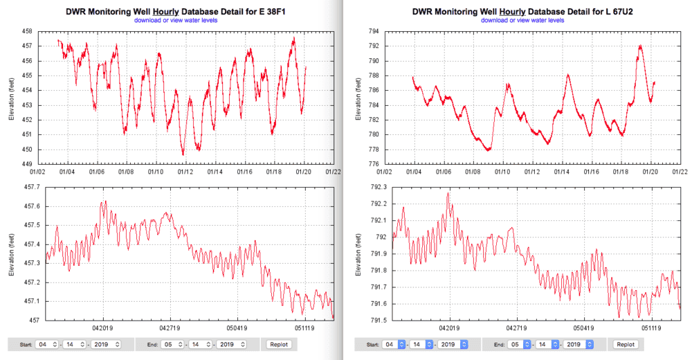

When I compare the two wells for 14 April 2019 to 14 May 2019 I see a good correlation.gNat said:I've attached another picture of hydrographs of the same time period from two wells. I've selected a longer time period (one month) for display in the lower graphs.
Lunar phases during the period were approximately as follows.
First quarter 13 April 2019 minimum amplitude
Full moon 19 April 2019 max
Last quarter 27 April 2019 min
New moon 05 May 2019 max
First quarter 12 May 2019 min
Full moon 19 May 2019 max
When the moon is full or new the tidal amplitude should be greatest.
A quarter moon should have lower tidal amplitude.
The three minimum amplitudes in the record appear to correlate with the quarters.
The pattern appears to repeat with the expected 14.75 day period. For example, there are four broad daily peaks before the minimum on 27 April, last quarter. There are then four broad daily peaks before the minimum on 12 May, first quarter.
So it is actually looking more tidal.
It would be interesting to see atmospheric pressure over the same period. Maybe the roughly weekly cycles of highest water correspond to narrow low pressure troughs, between wider, more stable, high pressure systems.
The longer 3 week decline can be explained by steady aquifer discharge.
It would be easy to get sucked into this research and analysis.
My hypothesis would be that the hydrostatic pressure in the aquifer is relieved by the Earth Tide.

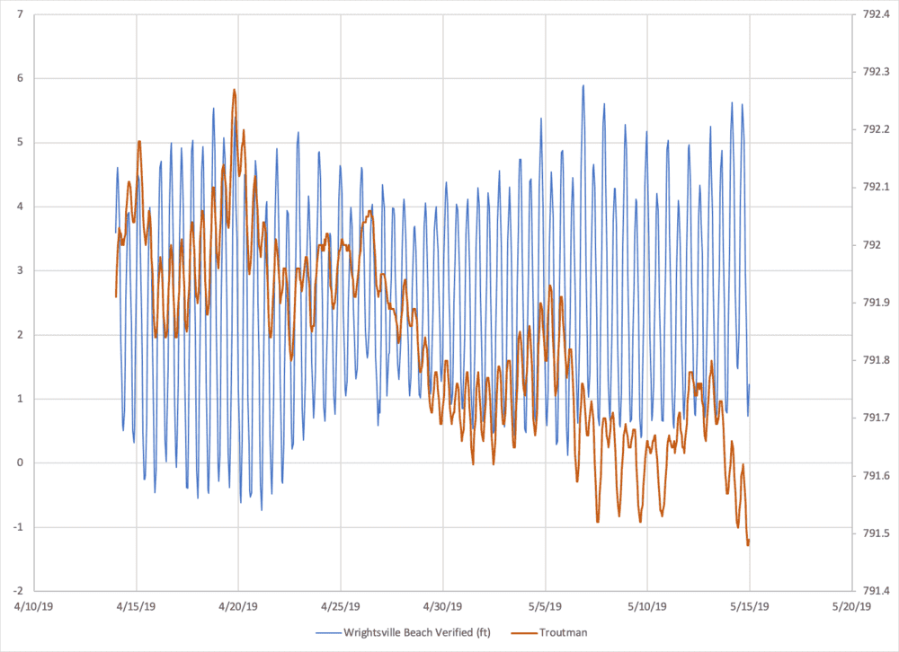

The two correlate remarkably well.gNat said:I've attached another image of the Troutman well water levels vs. the NOAA tidal gauge at Wrightsville Beach 8658163 both keyed to EST. Any thoughts?
Earth tides are not delayed by water wave propagation or oscillation as are ocean tides. Coastal tides are period selective filters so the waveforms will be different but the period will match.
It would be interesting to look at the model for Earth tide over the same period. Unfortunately my Earth Tide code is bent at the moment and needs some “end of leap seconds” therapy.

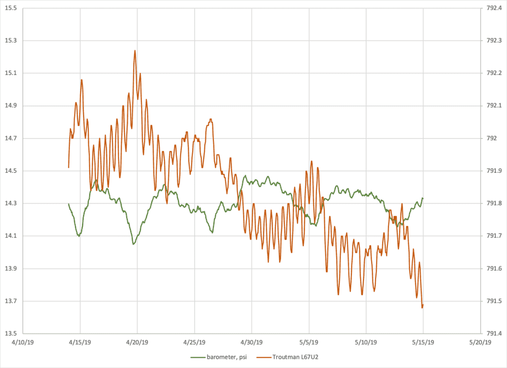

First, you're right about how fascinating the data can be. My job is analyzing the bigger wrinkles in the data which are associated with measuring aquifer conditions (drought and availability) -- more important to the citizens of NC.
We do have the barometer readings for the same time period which are part of the attached graphic. I definitely see correlation, but it isn't as in sync as the tide vs water level plot. I expect to see correlation with atmospheric pressure as this is a water table well (surficial aquifer).

Thanks for that atmospheric pressure graph. My atmospheric hunch paid off way better than I expected. I am surprised at how much the record can be cleaned up by subtracting an atmospheric component.gNat said:We do have the barometer readings for the same time period which are part of the attached graphic. I definitely see correlation, but it isn't as in sync as the tide vs water level plot. I expect to see correlation with atmospheric pressure as this is a water table well (surficial aquifer).
Where the water depth is measured with a pressure sensor, and the barometric correction applied, it is hard to separate out the source of the atmospheric component. Is it more or less reference tracking/calibration, or is it water level in the bore? But it does not really matter once a coefficient for the well/instrumentation has been determined.
For any water well I would compute two coefficients.
1. Atmospheric pressure correction. Recorded barometer.
2. Tidal correction. As predicted by Solid, Earth Tide.
When those terms are removed from the data you will be left with the long term discharge-recharge process, plus the noise floor. The frequency components of the signals are identifiable, or well separated.
I do take a lot of convincing, but I now believe that Earth Tides can be detected in water well levels.Baluncore said:I am surprised that Earth Tide can be seen in the record. I would expect the Earth to rise and fall with the ground water. I am going to take some convincing.
As a model/mechanism, I see the weight of the rock changing with the tidal variation of little g. That changes the compression in deeper rock which is detected by the displacement of interstitial water from the rock volume.
It would be interested to see how the tidal coefficient for different wells correlated with different geological environments. There may also be some interesting delays in the response.
I would expect different coefficients for different rock types/structures. A granite would have few horizontal fractures (unloading) that communicate with the well. A deep porous sandstone might give a greater tidal signal. Regional fracture zones would complicate the correlation.
Now back to the OP. Is there enough variation in NC well geology to indicate what rock type or structure is best for detecting the Earth Tide?

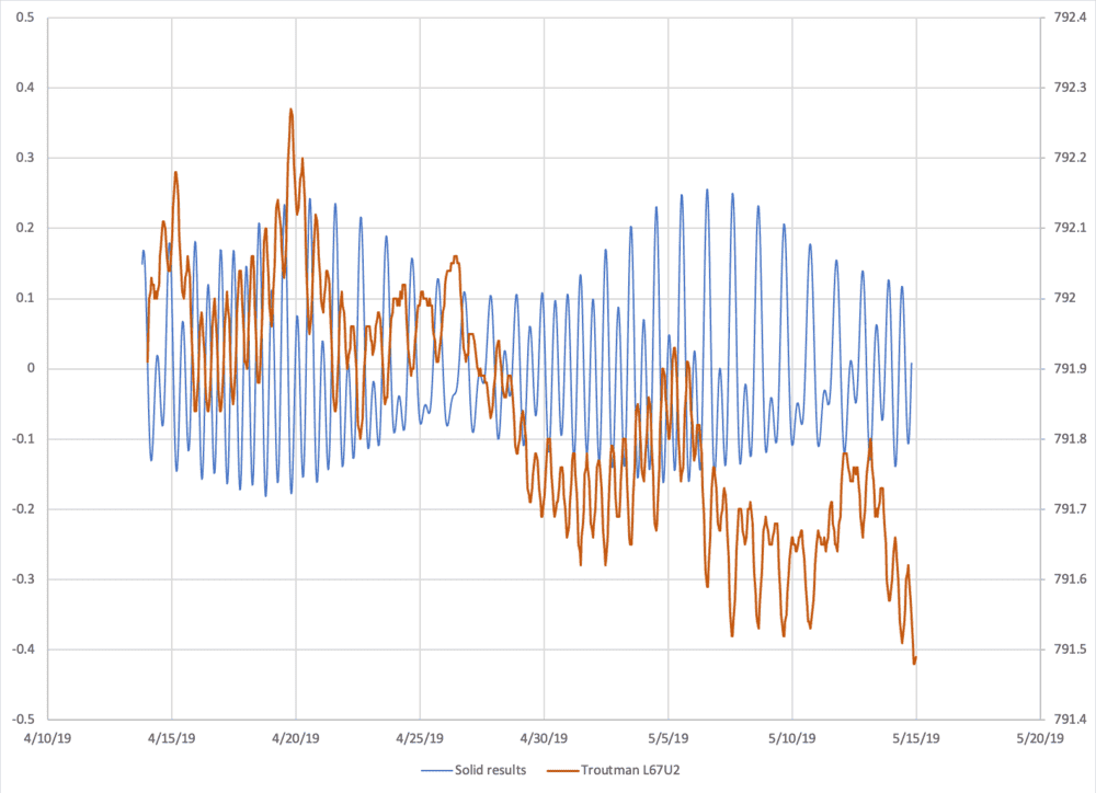

We have a bunch of wells, NC has diverse geology, and we don't always see the ripples we associate with Earth tides, so I'm guessing that some of those questions can be answered with enough effort. For example many of our wells are in coastal plain sediments (rarely lithified) and we don't see evidence of Earth tides, although (if memory serves) I've seen them sometimes in very deep coastal plain wells (1,000+ feet).
I used Solid with the link you sent and a bit of manipulation to get a month's time and subtracted 5 hours to make the results in EST and produced the attached graphic. I see that Earth tides have the same period as ocean tides, but there are interesting inflections based on the phase shifts associated with the lunar and solar components. I've plotted the Up component (meters) against the Troutman (L67U2) hydrograph (elevation in feet above msl). Similar to atmospheric pressure, it is negatively correlated with the water level changes (higher Up component means lower water level). Does that make sense?
I hope to incorporate Solid results in a future web page to allow more comparisons and an analysis of how rock type may influence Earth tides measured in our water levels.

Seeing the same signatures in both records as the solar and lunar components slide past each other over the month is very convincing. The tides are reinforcing and cancelling as expected in both records.
Understanding why the graph is inverted requires a simplified hydro-geological model. There are two different scenarios, both result in the water level in the well moving with a reversed phase when compared to the solid Earth or the ocean tide.
I am working on a clearer explanation of the model.
Yes. That is correct.gNat said:Similar to atmospheric pressure, it is negatively correlated with the water level changes (higher Up component means lower water level). Does that make sense?

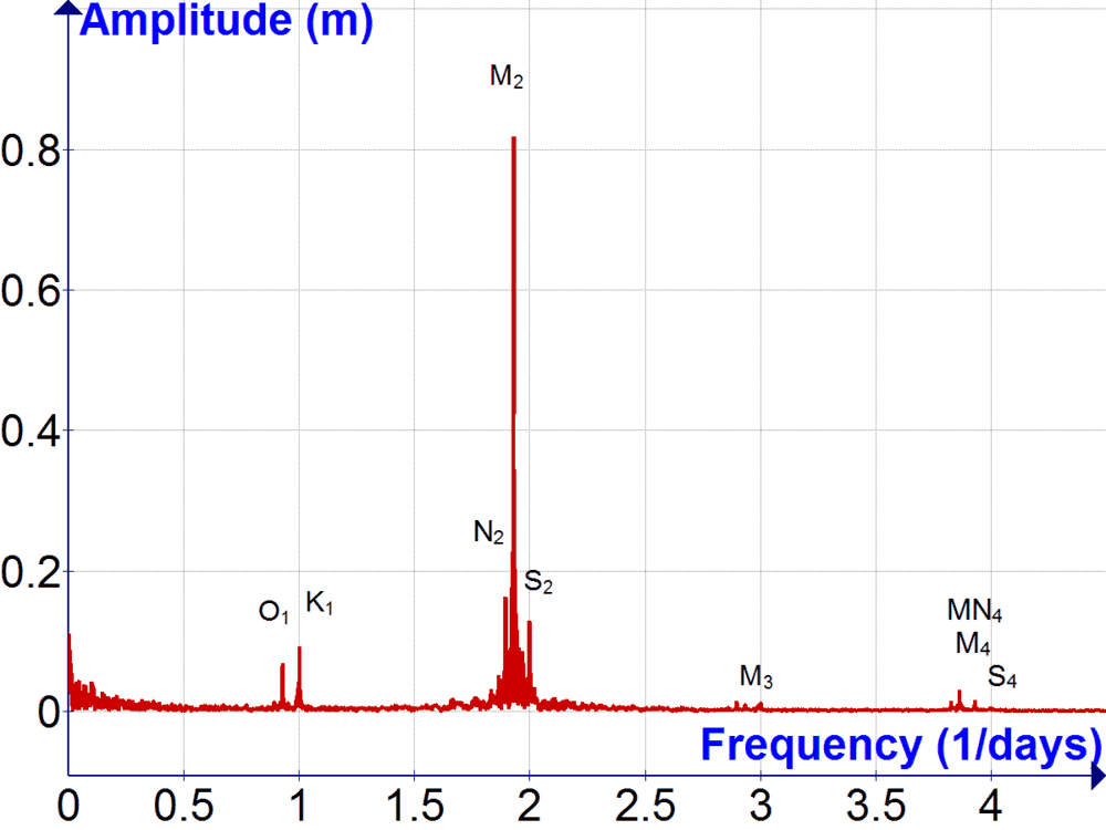

The figure below shows that the Fourier transform works very well at finding nearly all the expected water tide peaks at low frequencies with a year's worth of data. Sure, with the Earth tide data, the solar peaks may be difficult to separate from the systematic noise from the ionosphere. But the larger lunar peaks (O1, K1, M2) should be fairly easy to find, identify with confidence, and determine amplitude estimates. In any case, nothing against numerical correlators, but with a year's worth of raw data, one can do a lot with freely available code. https://sourceforge.net/projects/amoreaccuratefouriertransform/
Note however, that I recommended a Fourier transform rather than an FFT. The code used for the graph below is a standard Fourier transform using explicit integration rather than an FFT.

That is expected for ocean tides measured against a shore reference. It has been analysed that way for over 150 years.Dr. Courtney said:The figure below shows that the Fourier transform works very well at finding nearly all the expected water tide peaks at low frequencies with a year's worth of data.
This thread is about the solid Earth tide. Measuring the GPS height at a fixed land station for one year will not produce such a clean analysis of solid Earth tide. On land, where there can be no possibility of a differential reference, I would expect to see GPS ionospheric delay variation noise swamping K1 and S2. I expect you will see an M2 sinewave, but without any detail necessary to identify the solar component of the solid Earth tide.

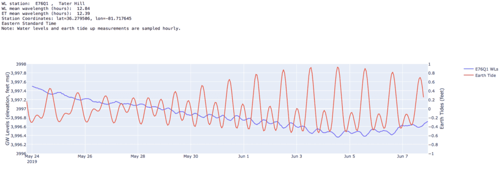

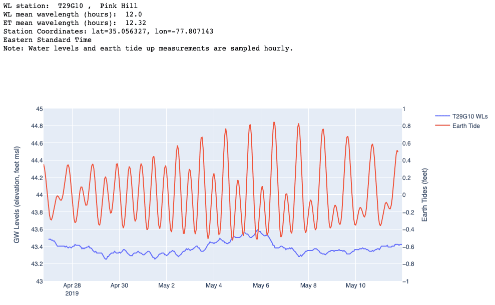

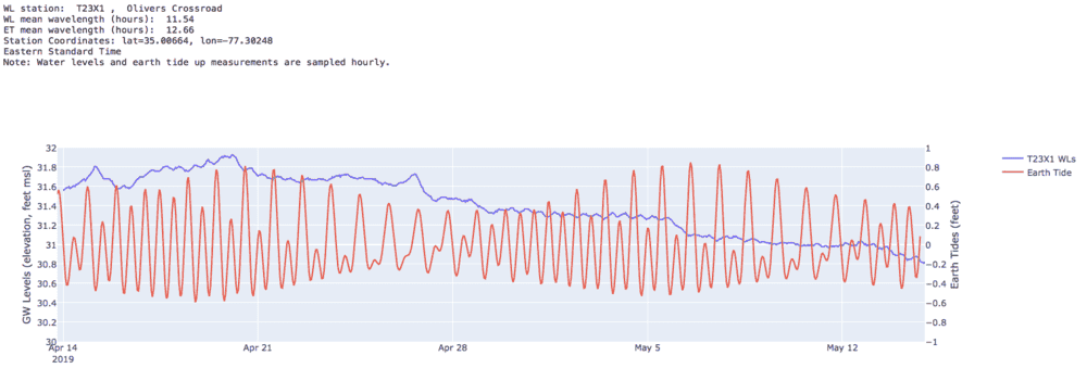

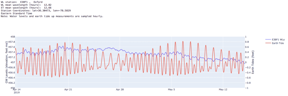

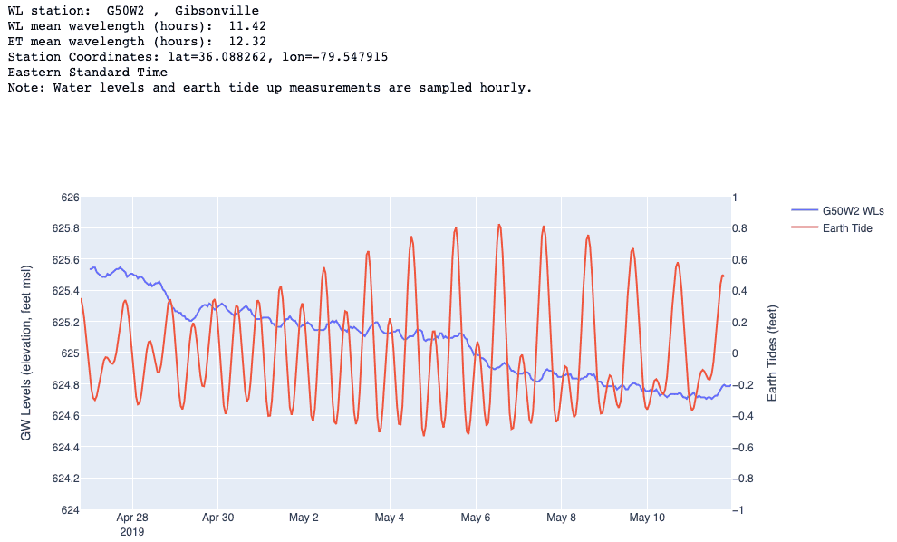

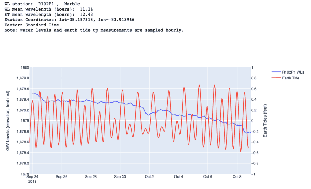

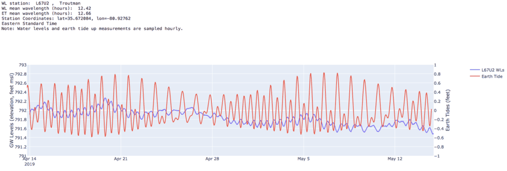

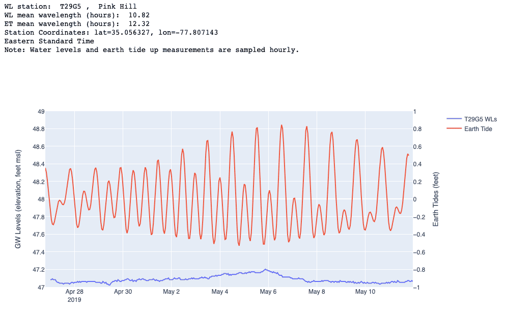

Sorry to be slow to post again. I was busy brushing up on my Python skills and building better access to the hourly ground water level data and SOLID.
I've attached eight pictures (sorry) of graphs which combine ground water levels from various stations in our network (across NC) and SOLID results from those locations over the specified time periods. Each graph is set up to show the same range of distance (in feet) on the two Y axes, so amplitudes of both Earth tides and water level fluctuations can be compared. I've identified the rock type associated with each well in the file names.
A couple of things are becoming clear. Well-foliated metamorphic rocks seem to show the strongest amplitudes and more massive or less indurated formations yield weaker to no Earth tide influences. In a few of the graphs I had to pick my timeframe carefully so as to show Earth tide fluctuations because recharge events swamped out that signal.
The two wells at Pink Hill are Cretaceous sand aquifers. The deeper, likely more indurated, shows Earth tides and the other doesn't (nothing recognizable).
I hope this is helpful to others. I know it's fascinating to me to get a better grasp of the forces influencing water levels in our wells. An Earth tide compression causes increased pressure on ground water which shows up as a water level peak. Larger openings in the rock, yield higher peaks. As the Earth tide de-compresses, ground water pressure decreases which causes a valley in the water level. Water level responses vary from non-existent to about 1/8 the amplitude of Earth tides (rough estimate).
