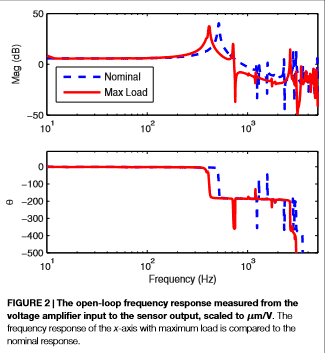

I think that first peak of the graph represent a resonance frequeny but i don`t know some peaks which are located after first peak.
Is it a just noise? or some other?

I `ll tell you more detail. The value what this plot measure is x-axis frequency response for nominal and payload.(I don`t konw meanig of nominal load and payload exactly... what is this?)
x-axis is one axis of nanopositioning system.

The graph text suggests nominal response when unloaded, compared to response with a maximum load.
Payload is not mentioned. I would expect it to be somewhere between the two.
It appears that when the load is increased to the maximum, the frequency of the first peak is lower, which is what is expected from a loaded resonant system. The fact that the phase cleanly changes by 180° degrees at that frequency confirms that it is a resonance.

The simple answer is that you should stay well below the first peak if you want good closed loop control.
The other peaks are other system modes probably, transverse modes etc...

You are looking at the open loop response of the system, how are you planning to use it? Closed loop?
