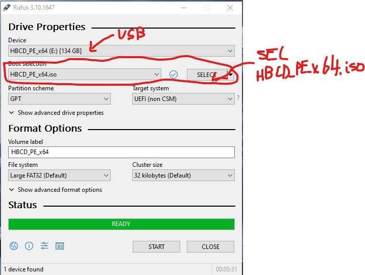

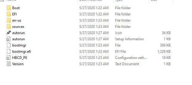

I followed exactly what you said, the green bar is completely green and the "START" button is black and ready. I hit the START again, it is copying the ISO. What do I have to do after it's all green? If the START is black again, what do I have to do? Do I click CLOSE?
I attached the picture of the Rufus setting according to your instruction. Also the content in the USB driver after it's completed.
Is the next step plugging the USB drive to the problem laptop?
Then do I just turn on the computer and let it run?( right now it is off).

sysprog said:
Yes. Close Rufus, plug the USB into the machine that has the password problem, hit F10 during the HP startup splash screen, select the USB device as the boot device, then follow the instructions in the https://turbofuture.com/computers/Using-Hirens-Boot-CD-to-Create-Admin-Accounts article to insert the new user account that has administrator authority. If you encounter difficulty. please post again.

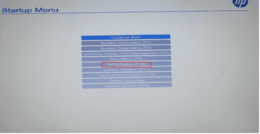

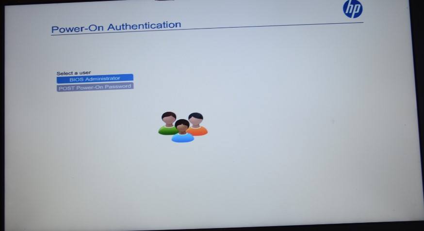

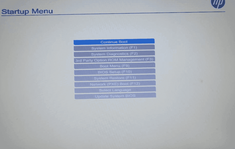

I took a few pictures...with camera! 1 shows the power on manu, 2 shows entering password, 3 show the option. I suspect one of them might go there

That looks good.
If you want to get rid of the BIOS password, you can go to the last option on the 3rd screenshot, then navigate to a Security tab, and from there to a Change BIOS Administrator Password option, where you can enter and confirm a new password of nothing (just hit enter when prompted to enter the new password and when prompted to confirm it) Then hit save and exit saving changes.

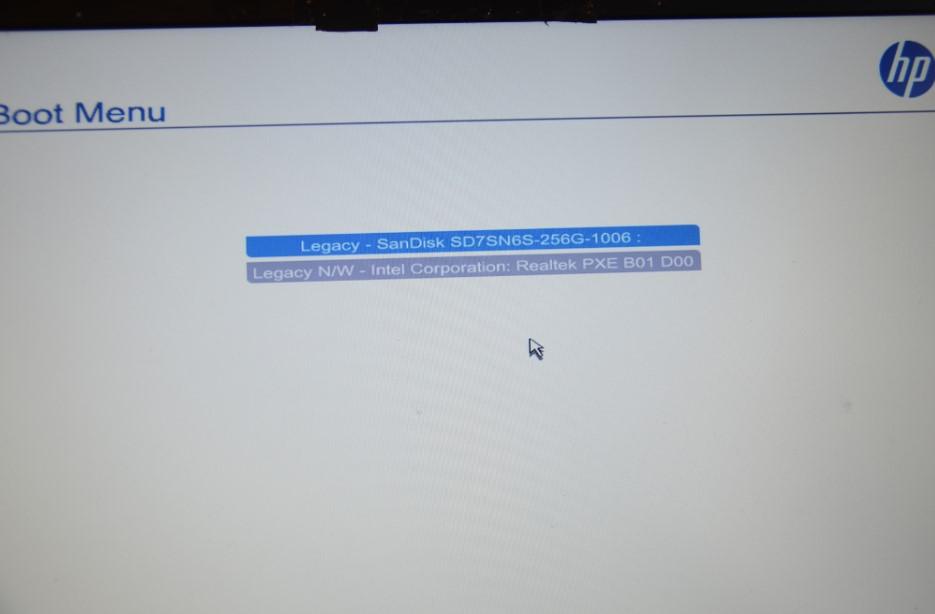

Also from that 3rd screen, you can hit F9 to get boot options, and from there, you can select the USB device.

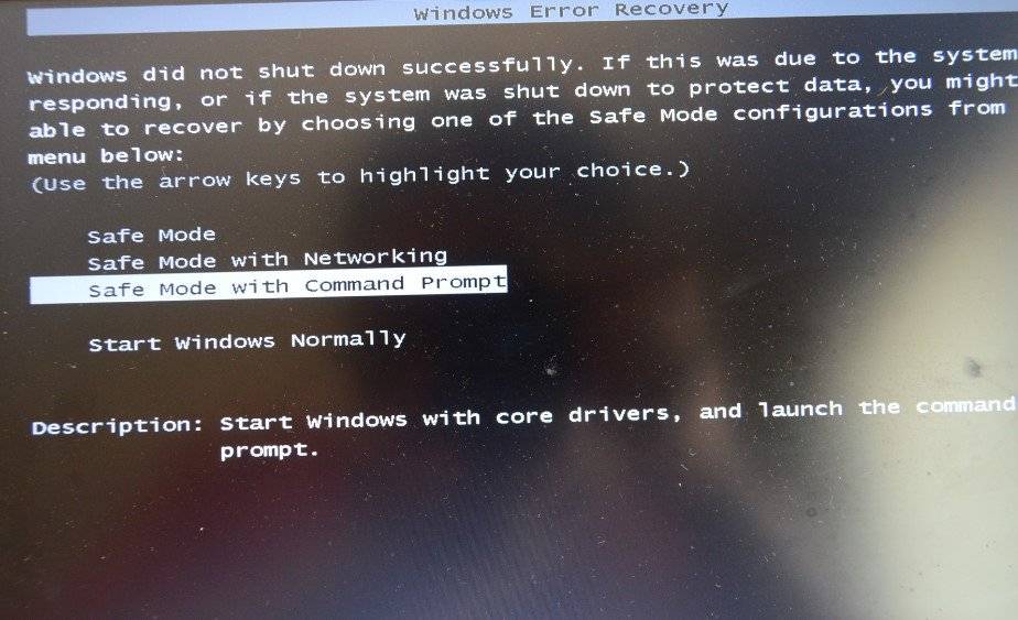

I tried F9 I got these two options, neither one going anywhere. Just gone to choose safe mode options and no matter what I did, it boot to ask me the password that failed.

To get the USB device to be listed when you hit F9, you'll first have to go into the BIOS Boot Options menu. You should from there verify that both 'legacy' and UEFI are enabled. You can also set the USB device to be first in the boot order. If you get stuck, please send more pictures showing where you encountered a snag ##-## BIOS screens vary, and my HP machine BIOS screens look somewhat different from yours.

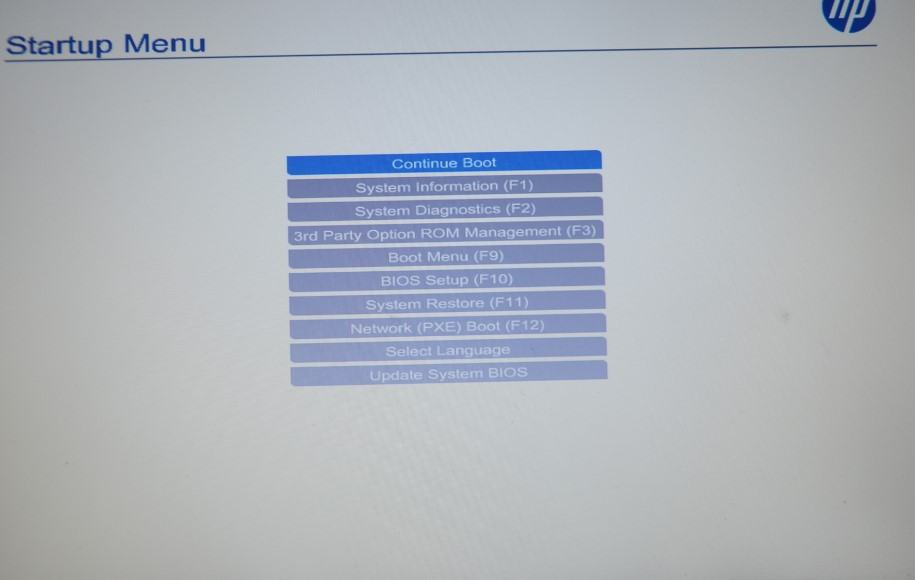

Given that you know the BIOS Administrator password, and that you can get to the 'Startup Menu' screen, you should be able, using the last (i.e. the 'Update System BIOS') option on that screen (arrow to it) to get into the BIOS settings. From there you can get rid of the BIOS password, and you can adjust boot device settings Please be persistent. If you get bewildered in the BIOS screens, please post pictures. If you make changes but are not sure about them, you can exit without saving changes, and then try again.

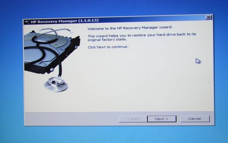

I hit F11 in the manu, I went to HP recovery Manager as shown in the picture. I did NOT click NEXT. I think this is going to wipe my drive and restore to when I first bought it. Everything will be gone. Is this true?

Yes. That's exactly what it would do. I don't see why you're so reticent regarding going into the BIOS settings as suggested.
Please go into the BIOS, so that you can do a fix, instead of a 'factory reset'.

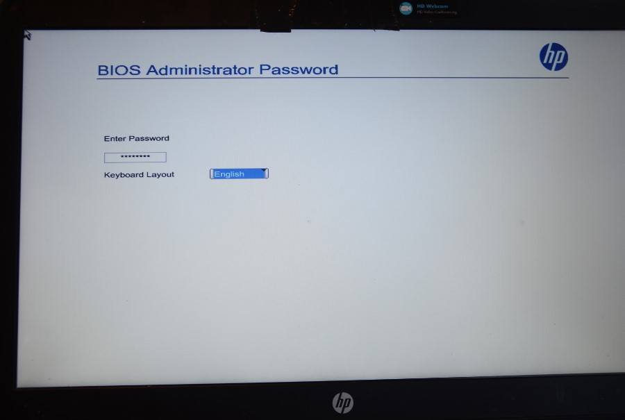

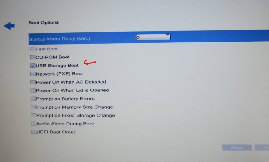

I Went to boot option in 6 and checked from USB drive as shown, I save that and it gave me the option of how to boot up as shown in 7, I chose safe mode with command prompt. It went right back to the problem page shown in 8 wanting the password. Back in the circle! I've been trying and trying.
I think a made a mistake, I never got into command prompt, it's was just some writing on a black screen and I thought it's in command prompt mode.
I'll keep trying, thanks for the patience.

What happens when you navigate to the 10th entry on the startup screen and hit Enter? Please show the first screen that you get upon doing that. What was the screen immediately prior to your 'Power on 6' 'Boot Options' screen (it's whatever screen the back arrow at the upper left is inviting you to return to)? On the 'Boot Options' screen, you should try checking 'UEFI Boot Order', and then see whether F9 shows the USB device.

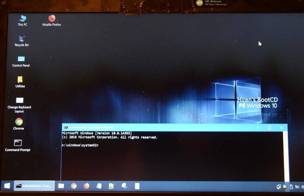

I spent almost an hour trying to do different power on and after entering password sequence to record down the outcome, I yet to get back to the boot up option choosing USB. I am going nowhere so far. I'll try again later to get to 6 above.
Yes, I think I got into the boot option and booted with Hiren's BootCD. I can even get into Command Prompt. Before I mess up anything, tell me what to do next.
There is Control panel, but function seems very limited, I looked at installed program, I can't see all the programs I have before. It almost seems like it's a new windows that is not the original windows I had.

That's good. The OS that you're running is a mini-Windows, soecifically a Windows PE (Pre-installation Environment) that loads from the USB device. Did you look at the https://turbofuture.com/computers/Using-Hirens-Boot-CD-to-Create-Admin-Accounts article and try to follow the instructions? Do you see an icon for an HBCD Menu? The icon should look like a wrench on top of a screwdriver. The follow article is simpler than the turbofuture one ##-## it references an older mini-Windows but the procedure is still the same: https://www.dvtitsolutions.com/blog...move-any-windows-password-with-hirens-boot-cd ##-## please post if you can't find the menu or you're encountering other difficulties, or if everything works, and you're able to fix the machine. Screenshots are helpful.
