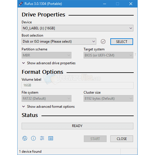

After copying any data that you care about from the USB device, plug it in and launch Rufus. You should get a screen like this (with your current version number in the title Bar):
Screenshot of the Rufus 3.0.1304 portable window showing Drive Properties with device NO_LABEL (J:) [16GB], boot selection set to Disk or ISO image, and a SELECT button, with Start and Close buttons at the bottom.
Make sure that the Device field shows your intended USB device.
At the Boot selection field, click on the down arrow and navigate to your Hirens .iso file.
Leave the other fields at their defaults.
When the Ready bar shows green and the Start button is not greyed out, that means that Rufus has found the device and the .iso file.
Hit the Start button.
If you get a warning about overwriting or destroying data it should refer only to the device listed in the Device field.
Assuming that you're sure that the correct USB device is selected, go ahead and ok the overwrite.
Rufus will announce it when the process is complete.
