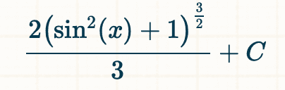

This is what I'm getting for the corresponding indefinite integral.

That's a good substitution, but I don't think you did the integral correctly. What is the indefinite integral of u^(1/2)?
