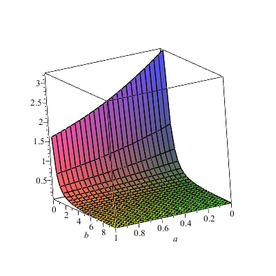

I doubt that the summation has a nice closed-form in terms of elementary functions, but it is expressible in terms of the non-elementary "di-Gamma" function. Maple gets
[tex]\text{answer} = \frac{i}{2b} \left( \Psi \left( 1 + \frac{a-i}{b} \right) - \Psi \left( 1 + \frac{a+i}{b} \right) \right),[/tex]
where ##\Psi## is the so-called di-Gamma function, defined as
[tex]\Psi(x) = \frac{d}{dx} \ln (\Gamma (x)) = \frac{1}{\Gamma (x)} \cdot \frac{d}{dx} \Gamma (x)[/tex]
and ## i = \sqrt{-1}##. Despite its complex appearance, the result is real if ##a,b## are real. Here is a Maple plot for ##0 \leq a \leq 1## and ##0 \leq b \leq 10##. (I accidentally made the plot with different upper bounds on ##a## and ##b##; I had intended to go from 0 to 1 for both. However, once I had uploaded the unintended plot the PF editor would not let me delete it and replace it by the correct one, without deleting the entire post. Anyway, the plot with ##0 \leq b \leq 1## does not look much different from the one attached.)
