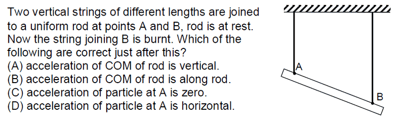

How can the motion of point A be determined in this system?

When string joining B is burnt , the forces acting on the rod are its weight , and tension in the left string ,both being vertical ,the acceleration of its COM would be vertical . Hence option A is correct .
Now how should particle at A move ?
Please help me with the problem .
Thanks

At t = 0 the acceleration of A will be positive to the right because the thread at A is vertical, thus not yielding any horizontal force ( B is burned ). The rod will begin to rotate clockwise, and the center of the rod will be kept in the same horizontal position. Thus A must accelerate to the right, and B must accelerate to the left.
We are speaking of the acceleration at t = 0+ ?
This is a possibility . But why must A accelerate to the right only . It can accelerate upwards and B can accelerate downwards such the COM of the rod accelerates downwards ?
Can this be proven mathematically ?

Can you show us your FBD for t=0+? The sum of torques and forces are non-zero for t=0+. That should help you start to answer this question...
Tension acts vertically upwards and weight acts vertically downwards on the rod .

Please see the attached picture .
So given that FBD, what is the sum of forces and sum of moments on the bar?

If there is a net torque around the COM, what does that tell you about the angular acceleration around the center of mass? How is the velocity of particle A related kinematically to the velocity of the center of mass and the angular velocity (vectorially)?
Hello Sir ,
Thanks for replying
There is a net angular acceleration around the center of mass = Net torque / MI
##\vec{v}_A = \vec{\omega} \times \vec{r} + \vec{v}_{CM}##
Actually, this is close, but is not quite correct. The correct relationship is:
$$\vec{v}_A = \omega r\vec{i}_θ + \vec{v}_{CM}$$
where ##\vec{i}_θ## is a unit vector in the circumferential (tangential direction). The time derivative of this is the acceleration of particle A. If θ is the angle that the unit vector in the tangential direction makes with the positive x axis, how is the unit vector in the tangential direction related to the unit vectors in the x and y directions?
##\vec{i}_θ = cosθ\hat{i}+sinθ\hat{j}##
OK. Now substitute that into the equation for the velocity of particle A and take the time derivative. (You can just leave the time derivative of the center of mass in dv/dt form). What do you get?
Chet
##\vec{v}_A = \omega rcosθ\hat{i} + \omega r sinθ\hat{j} + \vec{v}_{CM}##
##\vec{a}_A = r[\ddot{\theta}cos\theta - {\dot{\theta}}^2sin\theta]\hat{i} + r[\ddot{\theta}sin\theta + {\dot{\theta}}^2cos\theta]\hat{j} + \dfrac{d\vec{v}_{CM}}{dt}##
What is the value of the angular velocity of the rod at time zero? Substitute this value into your equation for a, and call the angular acceleration α. So what is the acceleration of particle A at time zero in terms of these parameters? What is the horizontal component?

To a first approximation, the acceleration vector at A at a small time t after release is (a, bt2) for nonzero constants a, b.
Specifically, if the radius of inertia of the rod is k, the horizontal distance between A and the mass centre is w, the angle of the rod to the horizontal is theta, and the length of the string at A is r, then ##a=\frac{w^2}{w^2+k^2}g\tan(\theta)##, ##b=\frac{a^2t^2}r##. (The vertical acceleration is, of course, centripetal.)
It follows that at t=0 there is only a nonzero horizontal acceleration, but that at any later time there is both horizontal and vertical acceleration.
##\vec{a}_A = rcos\theta\alpha\hat{i} + rsin\theta\alpha\hat{j} + \dfrac{d\vec{v}_{CM}}{dt}##
##\vec{a}_{A,x} = rcos\theta\alpha##
Good. Nice job.
But how does that tell us that net acceleration of the particle is in horizontal direction at t=0 :rolleyes: ?
We have to find the direction of net acceleration , not its magnitude .
Opps. I lost track of the problem statement. We need to address the vertical component of A's acceleration.
What is the vertical acceleration component of A at time zero?
What is the tension in the left wire at time zero?
What is the vertical acceleration of the center of mass at time zero?
If this is substituted into the equation for the vertical acceleration, what do you get?
(We're not done yet)
Chet
PLEASE DISREGARD THIS POST. IT IS BOGUS. THE OP HAD THE ANALYSIS CORRECT IN THE FIRST PLACE. SORRY FOR ANY CONFUSION I MAY HAVE CAUSED. SENIOR MOMENT.
BOTH THE OP's EQUATIONS IN POST # 24 ARE CORRECT, PROVIDED α IS THE ANGULAR ACCELERATION IN THE CLOCKWISE DIRECTION.
Actually, your equation for ##\vec{i}_θ## in post #19 is correct for θ being equal to the angle the rod makes with the negative x-axis (with ##\vec{i}_θ## pointing clockwise), rather than the angle that ##\vec{i}_θ## makes with the positive x axis. Your subsequent equations are correct for this framework. So, we can continue from where we left off.
