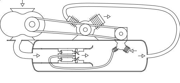

The fact that scuba tanks get too hot and might burst if filled too quickly leads to the most interesting question. If you had a new system for compressing air based on mixing inside the main tank, the atmosphere could be gotten into the tank with a supercharger. Air could be compressed so cheaply that the high pressure tanks could be dispensed with or at least not charged externally.
An intake pipe has a series of check valves inside the tank and the small volume between the check valves is pulsed with tank air using a large quick acting 2 way valve tee'd into it. The compressor just feeds atmosphere to this equalizer and has little work to do; most of the compressing is done by tank air. Thus most of the compression heat ends up concentrated in a small space which raises the intake atmosphere's pressure way above tank pressure and the result is a supercharged pulsejet pump inside an air tank driven by tank air.
No it isn't perpetual motion. The energy comes from the heat of ordinary atmosphere so it has a high COP like a heat pump. An analogous process has been used with steam boilers since 1850. Engineers argued that the boiler injector was impossible decades after it was available at Boilers R Us.
Thanks for the forum.

Several things seem oh so very wrong with this. There mere fact that you have to immediately jump to saying this 'isn't perperual motion' sets off the ******** detector alarm in my head.
First of all the above needs to be explained much much better, as its difficult to visualise.
What is driving this supercharger in the first place?
What are the flow rates of the two streams of air (I don't mean numerical just an indication of the relative flows)?
Why do you think that the atmospheric pressure would go 'way above' tank pressure?
How do you hope to get more energy out of the air than you initially put in as there appear to be no other sources of energy.
(And don't say that COP allows more energy, as it doesnt. Heat is not the same as work)

the compressor has nothing to do with this topic at all. i assume there is a compressor that stores cool pressurized air and also stores heat that was produced during compression.
that's all that's needed to know about compressors in this very case.

Let's compare two ways of compressing air. Typically it is squeezed mechanically into a smaller volume. Or there is pressure equalization, filling a volume from a higher pressure volume. (A third way to compress air is by directly heating it.) Any way you do it, for a given weight of air at a given set of conditions, to get a certain pressure there is the same amount of heat involved.
But heat and temperature aren't the same thing. Scuba tanks are filled by pressure equalization. Filling them too fast is not safe because a lot of heat develops quickly and there's no time for it to dissipate. Over-pressuring the tank is the result.
My design goal is to turn this phenomena to my advantage. The potential for a normal amount of air to develop more pressure than expected because of very fast delivery is easily explained.
In mechanical compression the compression and resulting heating takes place in the compressor, not the plumbing or tank. Air is delivered fairly slowly to the tank after substantial cooling has already taken place. In pressure equalization, the compression and same resulting heating all takes place in the tank.
Textbooks warn about keeping oil out of the plumbing. A few drops of oil in a closed pipe that is suddenly filled with high pressure air might explode and burst the pipe. This class of phenomena can be advantageous but oil is not needed.
Imagine a normal piston compressor feeding a tank that is pre-filled to 200 psig. This tank (not the compressor) is the source for compression by equalization of a smaller volume. For the sake of fast equalization the smaller volume to be filled from this source is placed inside the tank. This is the equalizer.
The intake pipe extends into the tank and is closed by a series of two check valves with a space between them. The intake pipe has to be large enough to accomadate the amount of atmosphere that will enter the equalizer at slightly above atmospheric pressure.
In the intake pipe between the two check valves is a large port that is open and shut by a fast acting valve that can be controlled by some convenient means.
When the equalizer is full of atmosphere the big valve on its side opens and if not for compression heat the resulting pressure would be about 199 psig in both tank and equalizer. But thermal equilibrium is not reached as quickly as pressure equalization. If the equalizer is well insulated there won't be time for the "no work" final result of free expansion. The rush of tank air into the equalizer compresses the air in the equalizer and the compression heat is trapped in the equalizer by the closure of the valve. If the valve were left open for a long time, thermal equilibrium would be reached and the resulting pressure in both tank and equalizer would be slightly less than 200 psi. But this is a way of overshooting equilibrium and the whole tank has contributed a little of its heat to the contents of the equalizer which blast into the tank en masse.
The sudden departure of the equalizer contents creates a momentary depression or relatively low pressure zone at the equalizer's intake check valve and the next charge of atmosphere enters under its own impetus with the help of the compressor which is only acting as a supercharger. Not resisting tank pressure.
The air compressor as we know it is an outdated machine. Simplistic thinking about compressed air has people assuming that pressure is just pressure, never mind the details. But the pressure in any container can change according to the motion of the air inside. Still air gives the maximum reading on the pressure gauge, that is static pressure. If the air moves in the tank, the pressure goes down till the air stops moving. There are any number of ways to get air into a tank. As the skeptics inform us, trying to design a more efficient air engine is a waste of time. A cheap way of compressing air is what is needed.
The equations for pressure equalization are simple but hard to find. They are implied in a few air brake manuals but spelled out in only a very few.
The condition of a given batch of air is constant as defined by the combined gas laws pv/t = Constant.
Full equalization of two conditions (waiting for thermal equalization too) results in the sum of the two original constants. pv/t of the compressing source + pv/t of the compressed destination = a new pv/t.
For the process I'm talking about we don't wait for thermal equalization so the sum of the two original pv/t conditions = the sum of the two new pv/t conditions.
Gumpfer
Sorry, I got a little bored and didn't read through your entire essay, but I thought you might like to have some more information about the combined gas law: It's combined, it's about a gas, but it only applies to ideal gases. Real gases can be taken into account by using a compressibility factor, otherwise your equations break down at high pressures and (low)temperatures
also, if you're getting your theory from air brake manuals, I'm a bit worried. Try wikipedia or your local library for a good text on thermodynamics, they're easy to find.
  • #53
The equations for pressure equalization are not spelled out in any thermodynamics textbook I have seen, nor in any compressed air textbook I have seen. I was hoping to hear from people who are interested enough to read my post, if you're too bored to read my post before responding to it then perhaps you are trying to keep yourself awake by insulting an idea you have not thought about? No thanks, I am bored with skeptics who know all without investigating first.
  • #54
Well I did try to read your post, and like redargon, could not follow it all the way through, but I do think you are trying to describe this concept (or basically a jet ejector system) which I think has merit.
http://www.aircaraccess.com/images/magkvalv.jpg
Ron
  • #55
yes, but the fundamentals of pressure equalization has to do with thermodynamics: Boyles Law, Ideal gas law etc. I was just hoping you were open enough to accept some constructive criticism about how the combined law may (or may not) be applied and how this can be adjusted for by using compressibility factors. I'm not being skeptical, because I did not read through your whole post, but your approach to the combined gas law jumped out at me and I thought I'd offer some insight.
P.S. I tried reading through your post again and started getting confused (I'm apparently no the only one). Maybe you could add some sketches and also the equations of pressure equalization that you have so that we can discuss those as well and so that the idea is a bit more accessible to everyone.
  • #56
Here's the sketch Ron linked to.
This is old stuff, based on patent no. 2030759 but complicates it. My idea is to simplify that idea by Bob Neal (1936, now in public domain) not complicate it.
The patent shows a tank with an intake pipe entering and dumping air into the tank through two check valves. That's all. No explanation of why it should work, but the inventor did show a working model in order to get the patent. This sketch adds hardware to make it maybe seem feasible. I don't know about the jet pump idea though, the compressor in the tank that supplies drive air might have to move a lot of air and I'm saying it can be done very simply.
The general idea of the "Neal tank" is to make a new kind of compressor that doesn't resist the pressure that's in the tank already but puts atmosphere into the tank "somehow" and let's the compression take place by equalization with what is already in the tank. The "somehow" is the question. The energy source is the internal energy or heat of the incoming atmosphere adding to the pool of energy already in the tank.
Info on air brakes is not to be sneezed at, it stops trains so it had better be right. But the reduction to math is not easy to find. I did find it though about 1.5 times. And it's easy math.
PV/T = constant. Roughly. I know air is not an ideal gas but all the books use this for all practical purposes. So if a fixed quantity of air (a certain weight, a fixed number of molecules) has a condition pv/t, then if you change its pressure, volume, and or temperature, the value of pv/t will remain constant. The subnotations used below refer to different conditions with each separate batch of air being a different condition. For example 1 is atmosphere of a certain pressure, volume and temperature. The subnotation 2 is compressed air of a certain pv/t, a different constant. The subnotation 3 is a new condition referring to the new condition of a new batch of air, the mixture of the first two. This assumes complete pressure equalization and thermal equalization.
But if you don't wait for equilibrium then the result is two new conditions. For example if you fill a scuba tank (condition 1) from a higher pressure tank (condition 2), then the result is a hot scuba tank and a slightly cooled source tank. Conditions 3 and 4. Complete equalization is if you have perfect insulation on both tanks, leave the valve open, and wait for thermal effects to spread out through the combined volume of both tanks till all is equal. That doesn't happen (except in Joule's experiment which proves the energy is conserved, there is no external work done), you take your warm tank with you, the scuba filling station doesn't have time to reclaim their lost heat.
So I'm talking about a simple math I learned from air brake manuals because no one else cares about pressure equalization except odd stuff like player pianos and pipe organs and ear doctors. Google it--I'm not exaggerating. Pressure equalization is an ignored aspect of science except for stopping jillions of tons of train. Thermal effects aren't important in that application because large events are being handled by equalizing relatively large volumes with other relatively large volumes through a small pressure differential. My application involves equalizing a relatively large high pressure volume with a relatively small low pressure volume. It is the difference in size and pressure between the two conditions that creates a drastic surge of heat between the two check valves in the tank. The equalizer is suddenly filled with tank air and if it doesn't get super hot than why do we have to fill scuba tanks slowly? Overshooting equilibrium is dangerous, so it has to be done inside the tank.
Here is the math.
Complete equalization (aka free expansion, unbalanced expansion, unresisted expansion, partially unresisted expansion; discovered by Joule and once called "Joule's Law"):
P1V1/T1 + P2V2/T2 = P3V3/T3
Incomplete equalization (call it a surge-driven equalizer):
P1V1/T1 + P2V2/T2 = P3V3/T3 + P4V4/T4
To be perfectly honest, even the air brake manuals didn't have the last equation, since they ignore thermal effects until a pipe bursts, then I guess they have to clean oil out of their pipes so it won't keep happening. I think if the first equation is true then the second one is also correct. When you mix two pv/t conditions, you add them together to get the new condition.
This is derived mathematically from Boyle's Law, Charles Law, and the combined law, nothing mysterious. If you can ignore thermal effects then you just delete all the T's from the equations. My idea is to make the thermal effects do something with a forward surge past equilibrium and then not allow the disturbance to return. There is no time for full equalization; the heat causes all the air between the check valves to blast into the tank and a depression is left behind in the equalizer so that the compressor is only working against very little pressure instead of tank pressure.
Thanks again for any constructive criticism.
Gumpfer
