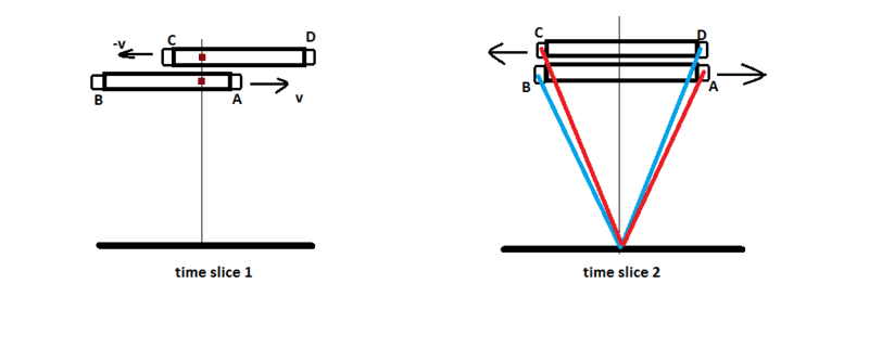

Let`s modify the experiment according to the last suggestion ( which is: no pattern will form)
Think of 2 trains moving in the opposite directions toward each other. That will be our train with velocity v to the right direction and another one with -v to the left direction. The first train has slits; A and B and the second one has; C and D as shown in the diagram. Their mid-points will coincide at a corresponding point in a ground screen when rays leaving slits ( we can make them very thin trains with slits from them at 2 sides are so closed together)
This will make the D-shift from A matchs that from C and B with D,,, ultimately the pattern will form! ( the color of lines in the diagram indicates the Doppler shift)
If so:
1) will the 2 trains move in opposite directions With their sources moving altogether is equivalent to the classical pattern where There is only one fixed source relative to the ground and nothing moving?
2) According to QM, there would be no pattern if more than 2 slits are there and we got 4 slits now! ( forget this point for a while as the number of slits should be in one direction)

OK, there is no fixed pattern in either frame, using your meaning of fixed. There is, however, an interference pattern in both frames. In one frame the pattern is stationary and the ground is moving, in the other frame the ground is stationary and the pattern is moving. The pattern is there whether or not you are interested in it.
I am not interested in analyzing new experiments for you. You have been given enough input and instruction that it is now time for you to take responsibility for your own analysis. If you get stuck at some point then please post your work up to that point, and if you want me to check your work I will be glad to. Once you gain some skill in working these problems then you will be able to answer many of your own questions, and hopefully those of other people.
However, you need to know one thing in advance. The behavior of interference patterns are completely governed by Maxwell's equations, and Maxwell's equations are invariant under the Lorentz transform. Therefore, you will never find a situation where interference in one frame is not interference in another frame.
