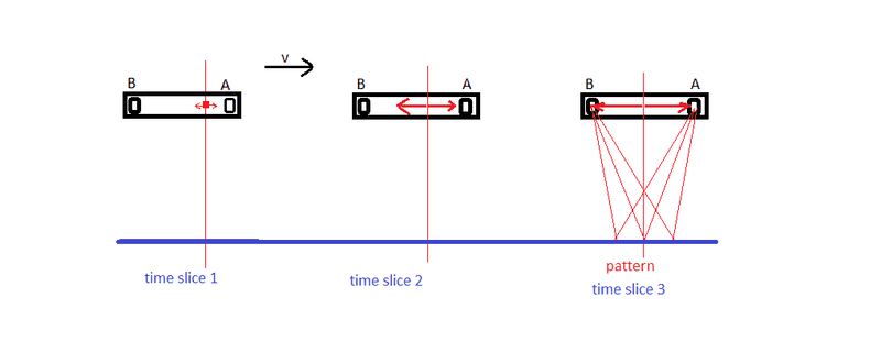

A train is moving from the left to the right direction. There is a light source emitting 2 beams of lights toward 2 slits A and B at both ends of the train. The source is put near the slit A Than B.
A ground observer is watching the scene and sees that the 2 light rays reaching A and B simultaneously and in-phase to form a pattern.
However, the train observer sees that the light toward A takes a shorter path than light toward B which makes the ratio between those 2distance and the wave length of the light not necessarily the same in order that the 2 beams arrive in phase!
So how the phase become a physical invariant value?

Can you draw it, because it is not at all clear from your drawing. In fact, the ground isn't shown in your drawing. I don't know if this picture is looking from the side, the top, or the front. Also, the only way I can think to combine the beams given your arrangement is more like a mirror than like a slit, so I am not sure how that is going to work. You do understand that slits diffract, not reflect, right?
Also, Mentz114 is correct. It is not required that the two waves be in phase, merely that they be coherent. See the first paragraph of the Wikipedia link I posted earlier.
Adel Makram said:
my topic is clear from the first post!
No, it wasn't. If it were we wouldn't be at post 12 still with no idea how there can even be interference here.
Are there a total of 4 slits, 2 at A and 2 at B, or are there a total of 2 slits, 1 at A and 1 at B?
And where does the light go after it passes through the slit(s) at each end of the train?
There r only 2 slits, one at each end
Light goes to a ground screen

The blue line is the ground screen, the train moves in the right direction,,, it does not matter wether I put mirrors or the slit emission is done by diffraction https://www.physicsforums.com/attachment.php?attachmentid=46253&stc=1&d=1334500883

Actually, you need both mirrors and slits for this configuration to work. So you could have the light go out from the source above the slits, then the mirrors reflect the light in and down to the slits, then the slits diffract it to the ground making an interference pattern.
OK, so now that I understand your scenario, what is your concern?
will the wave- phase when light exiting slits be an invariant physical value?
Yes. But simultaneity is not.

Yes, the phase of a signal at any given event is a relativistic invariant. I.e. all frames agree on the phase at any event.
I know the statement, I want the proof
I found this fairly convincing. If you have any questions, please ask.
Mentz114 has provided one proof. I prefer to simply note that (in units where c=1)
[itex]k^{\mu}=( \omega, k_x, k_y, k_z )[/itex] is a four-vector and
[itex]x^{\mu}= (t,x,y,z)[/itex] is also a four-vector. So then
[itex]\phi=\omega t - k_x x - k_y y - k_z z = k_{\mu} x^{\mu}[/itex] is manifestly a scalar.

One more thing, I think the pattern will not form any way in this particular set up. Although the phase is always equal at Slits A and B relative to the ground observer because the arrival of the wave front at the same time, yet the Doppler shift at slits makes the interaction of those waves of different wave length after leaving the slits not possible.
Still my concern not about the pattern but about the relative phase at A and B for the train observer!

Suppose that we set up a pair of clocks at each slit. Suppose further that one clock reads 12:00:00 when the phase is 0 at one slit and the other clock reads 12:00:01 when the phase is π at the other slit. Then, in all reference frames when the first clock reads 12:00:00 the phase is 0 at the first slit and when the other clock reads 12:00:01 the phase is π at the other slit. This is what it means for the phase to be a relativistic invariant.
