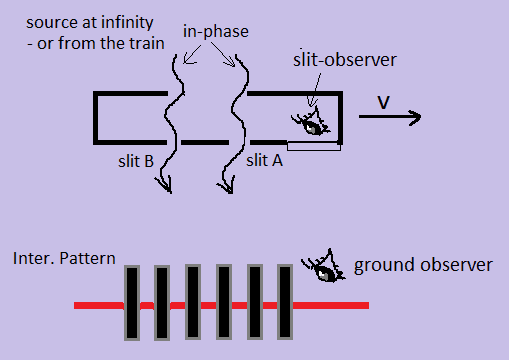

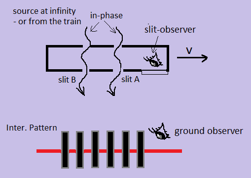

I posted this thought experiment in a previous thread before 4 months or so, but I would like to reiterate it now:
A frame of reference (FOR) has double slits moves relative to a ground FOR. Let`s make an arrangement so that when the 2 ends of FORs coincide, 2 small slits of moving FOR are opened at the same time relative to the ground observer for a brief moment to allow just 2 photons to enter from an electromagnetic source put on the opposite side of him. Let `s make the distance between the 2 slit small enough comparable to the wave-length of the photons to cause an interference pattern.
For the ground observer, he sees 2 slits open at the same time and therefore the 2 photons entering the 2 slits and create an interference pattern on a screen on his frame.
But according to SR interpretation, the moving FOR`s observer sees the front slit opens for a brief moment and then shuts before the rear one opens,,, so at one time, only one slit opens and therefore no interference pattern could ever occur. But when he looks at the screen from his window, he will see an interference pattern on the ground screen.
Can the train observer now explain why this interference pattern occurs when just the slits open one at a time?

I don't know what the observers will see because I can't work out the arrangement of slits, screen and emitters. But all observers will see the same pattern, whether it is dots or bars.
Diagram of a double-slit interference setup on a moving train: slits A and B in a barrier, in-phase wavefronts passing through, a slit-observer riding with the train moving right at speed v, and below it a ground observer viewing an interference pattern of vertical bars along a red line.

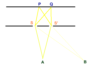

The diagram shows a 2 slit setup. P and Q are bright spots, where the interfering beams are in phase. A and B are observers. The slits open for a small time simultaneously from A's point of view. Observer B does not see the slits open at the same time1. Will B see the same pattern as A, or something different ?
Nothing is moving in this setup.
[1] if the slits are open for time T, then if T< (SB-S'B)/c then B will see one slit open and close before the other opens.
