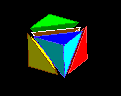

Given only water and a cubic container with one open face, how can you fill the cube to one-sixth its volume?
Mathematics news on Phys.org
Without thinking too much about this, I imagine the solution has to do with tilting the cube so that the volume between the lowest point of the cube, and the lowest point on the open face, contains 1/6 of the total volume. Also, there should be some simple visual check by which one can tell that the cube is in the desired orientation.

Tilt it until the surface of the water is a triangle, whose sides are diagonals of the faces of the cube.
[edit] oh someone else did it already. doh.

It is not obvious to everyone, but Xitami seems to have solved the problem. Look at the image in his post #4, and imagine that the red+ blue face is the open one.
Fill the cube more than 1/6 full of water, then tilt the cube so that the yellow corner is straight down and water is running out. Adjust the cube's tilt so that the level water surface just touches the corners indicated by the yellow volume, so that the amount of water is equal to the yellow volume shown.
I am actually having difficulty visualizing why this is equal to 1/6 of the total, but there is probably a simple way to do this. (Too lazy to pick up a pen and paper and sketch this out right now.)

Volume of a pyramid?
1/3*1*1/2*1*1 in this case.
(edit: the 1's are the height and perpendicular dimensions of the base triangle)
(another edit: is there an elementary proof of that formula? ie, the fact that it doesn't matter where you put the "top" point of the pyramid, as long as it's h above the base. not that the calculus is difficult but...)
Yea Jerbearrrrrr! The way I put it is:
Fill the cube so the surface of the water intersects one corner on the open face and two corners diagonal to each other on the opposite face. [Remember, the volume of a pyramid, V=(1/3)(base)(height).]

I don't see why that should be necessary. The volume of a tetrahedron with edges of length 1 has volume 1/6. That shows that Xitami's solution is correct.
