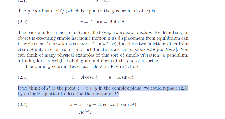

Snapshot of Mary L. Boas' Mathematical Physics book
So, the marked lines say `If we think of P as the point z = x +iy in the complex plane, we could replace (2.3) by a single equation to describe the motion of P`
But, until now I have only learned of representing points in the form (x,y), now I wonder how I can represent a point on any plane (trying not to say "imaginary" here) using z = x + iy

It is obvious as you say and I thought of that first when I read that, but how do you differentiate between when z = x + iy is a complex number and when it's co-ordinate in the imaginary plane.
Do we depend solely on the context of the text/given question?

hey mark, I was wondering if how I interpret z = x + i y depended on the context.
i.e., for example in the example I sited from Mary L Boas, I am supposed to interpret it as a co-ordinate rather than a complex number.
As you see Dave has already helped me. I thank you for your willingness to help :)
Thank you very much @DaveE ! You have been very helpful today :smile:
