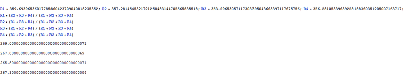

Mathematica is able to find exact solutions, but they are VERY complicated. Here is an example of just one solution for R1:
Numerically, here is a solution good to quite a few decimal places, with the four expressions evaluated with the solution, showing its accuracy:
