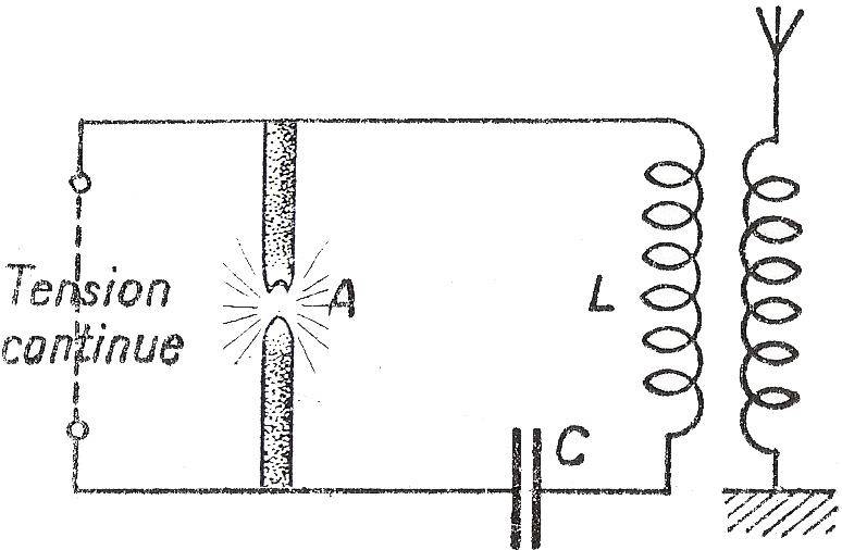

Hi everyone 🙂
I have read this article about the arc converter, also known as the Poulcen arc.
https://en.m.wikipedia.org/wiki/Arc_converter
It was apparently one of the first electric oscillators. Apparently, an electric arc was produced between two electrodes to put in resonance a RLC circuit, which makes an high frequency electric signal. I note this is exactly the same circuit that Mr Nikolas Tesla used to design his Tesla coil. However, it is claimed that the Poulcen Arc was able to be powered on 50 volts, but the question is how ? I mean, the air has a great breakdown voltage (3600 V/mm), so how an electric arc could be drawn with oy 50 volts ? Even those who build Tesla coils needs to increase the voltage at some kilovolt to power their setup.
Please, could you tell me what I misunderstood ?
Thanks in advance 🙂

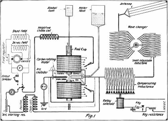

The electric arc in that circuit functions as a form of Current controlled negative resistance for a RF frequency oscillator.
https://www.st-andrews.ac.uk/~www_pa/Scots_Guide/RadCom/part5/page1.html
The tuned circuit stores energy supplied from the arc power source allowing for continuous RF on a single frequency at much higher usable transmitter power than the earlier spark-gap transmitters.
This transmitter used FSK modulation to transmit CW. The key 'on' would the remove the compensating inductance moving the frequency to the tuned range of the distant RF receiver and shift off frequency when the key was 'off'.

The arc oscillator, or singing arc, was invented by Duddell in 1900. It consisted of a carbon arc with a series LC circuit placed across it. It produced an undamped wave which could be modulated by a carbon microphone placed in series.
Notice this is fundamentally different to a spark transmitter, which produces damped wave trains. In order to form the arc, the electrodes are brought into contact then drawn apart. The later Poulsen arc gave high power, using a hydrocarbon atmosphere, such as ethanol or coal gas, with the arc working in a powerful magnetic field. Arc transmitters were typically used for low frequency operation but oscillation was reported up to 1 MHz.
High power arc transmitters of around 300kW at 24kHz were used from 1920 at Leafield, UK, for telegraph services to Egypt and the Empire. But when Rugby radio station was built in about 1925 it became possible to make valve transmitters of 500kW.

When you make "mechanical" contact between electrodes, letting the current flow through them this way, and then try to separate them, the current keeps flowing due to some inductance in the circuit. Therefore, no high voltages are necessary and as long as the voltage of the source is higher than arc voltage the arc will be sustained. And no, the primary circuit is not the same as Tesla coil primary circuit. In arc transmitter there should be present, as you can see in your drawing,certain resistance in a series with a spark gap, and DC source is a must. OTOH, the resistance in T. coil primary should be as small as possible and high AC voltages are usually used as a power source.
The arc is initiated when a momentarty contact is broken and the circuit inductance generates a high voltage spark. V = L*di/dt.
The low voltage arc is then maintained through the cloud of ions generated by burning alcohol from the drip feed. A flame has a low breakdown voltage.
