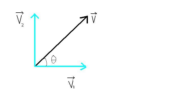

You need to resolve the velocity vector into two vectors! One towards the wall (perpendicular to the wall) and one parallel to the wall. You'll need to know the angle of velocity for that.
How can you do that?
  • Vector diagram with cyan axes: V2 points up, V1 points right, and black vector V lies between them at angle theta from V1, illustrating resolving V into two components.
i'm afraid i have no idea. I'm probably wrong, but to me that sounds like a tiny modification of the same problem
what exactly do you mean the angle of the velocity? as defined in radians or degrees relative to world up?
