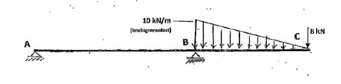

How do I find deflection (displacement) in point C at the end of the beam? Answer is to be given in mm. There is a roller connection (only Fy) in B and an external pin in A (Fy and Fx). The module of elasticity and area moment of inertia is given.
Beam diagram: pin support A at left, roller support B in the middle, free end C at right. A triangular distributed load rising from 0 to 10 kN/m labelled bruksgrenseløst, and an 8 kN point load pointing down at C.

First, you are going to need to know E, I, and LAB and LBC.
I tried solving this using the unit load method.
I = 57.9 * 10^6 (mm^4)
E = 2.1 * 10^5 (N/mm^2)
AB distance = 3 meters
BC distance = 2 meters
https://dl.dropboxusercontent.com/u/11241083/Solution_Beam_Problem.pdf

raymanmusic: I now also used a second method, and I got exactly the same answer I got using a completely different method in post 4. Therefore, I am about 99 % certain I have the correct answer.
You did excellent work in post 3, but it appears you made one main mistake, as follows. Delete your unit load at x2 = 666,67 mm, and then try your solution again. You do not want to find deflection at x2 = 666,67 mm, and you therefore should not place a unit load at x2 = 666,67 mm. Try again.
By the way, always maintain four significant digits throughout all your intermediate calculations, then round only the final answer to three significant digits. E.g., -7,556 kN, not -7,56 kN.
Thanks for helping me out nvn. Do I place the unit load where I want to find deflection? What about the triangle load? Should I ignore it when I calculate mx2? What did you get as your final answer in mm?
raymanmusic: Yes, place the unit load where you want to find deflection. Yes, ignore the triangular load when you compute mx1 and mx2. I will let you know if you obtain the correct final answer, if this is not a test question.
I got approximately 5.922 mm as my final answer. Is this close to the correct answer?
Excellent work, raymanmusic. Your answer is correct (5.921 54, which rounds to 5.92 mm).

deflection101 came with a formula for this case,Where is it?
given: w=10kn/m
p=8kn/m
a= 3
b=2
EI=1 (to simplify)
Ans.:yc= - 72 (-160/3 - 56/3)
EIy(x)=wx/360b(3x^4-15bx^3+30b^2X^2-30b^3X-20ab^3)+Px/6(x^2-3bx-2ab)
EIy(2)=-72
y=- 72/EI EI=read above
