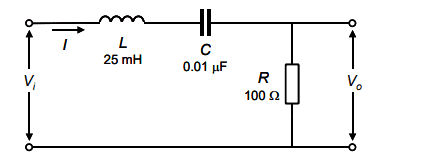

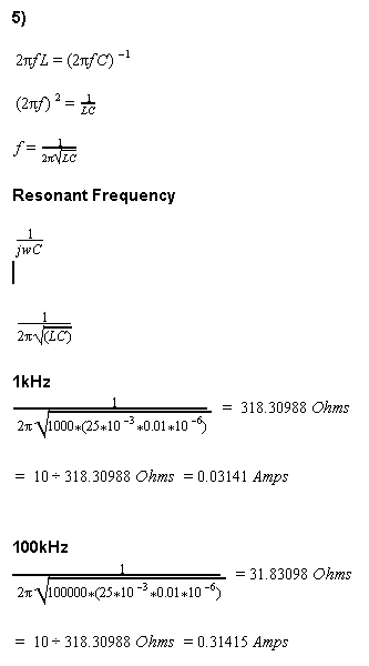

Hello ,am posting this thread because i need help with 1Q , i was told by my tutor to measure Vo and Vi over the range of frequencies 1khz to 100khz , but i have no idea how to do that ,am not very good at maths and that's why i been really struggling to do it , i have tried doing it but am 100% that i have done it wrong .
Spec :
Voltage source =10V
L=25mH
C=0.01uF
R=100 Ohms
i have also attached calculations which i have done .
any help would be great )

Welcome to PhysicsForums. :smile:
It looks like you are calculating the impedances, but they are asking for the transfer function ##\frac{V_o}{V_i}##
Can you work on calculating that transfer function (it's a voltage divider with the complex impedances used)...
