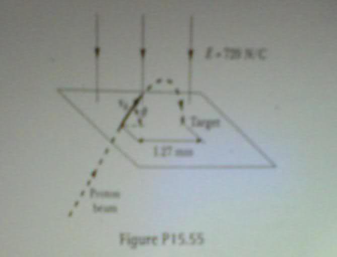

Hey , I am a new member Here . I am having some diffuculties , i did one problem and still 1 problem i can't do it coz it seems very hard as i am new to gauss's Law
I am doing college physics II , protons are projected with initial speed of v0 = 9550m/s into a region in which a uniform electric field , E= 720N/C is present . the protons are to hit a target that lies a horizental distance of 1.27mm from the point at which the protons are lauched.
Find the two projections angles that will result in the hit .
b- the total duration of flight for each of thse two trajectoires.
I tried to do these E= K.(q)/r^2 , E.A.cos (x). well i don't have any clue...
I hope you can help me
Thanks

Welcome to PF.
You can treat it like a traditional projectile range problem.
http://www.physics.ubc.ca/~outreach/phys420/p420_00/darren/web/range/range.html
To figure your acceleration you can use:
[tex]\vec{F} = q * \vec{E} = m * a[/tex]

sorry i am not very good in physics , do i need to use this ?
we have x= 1.27mm / so i can get the sin ?

Once you figure g you can solve for θ.
g is 10 right ?
Gaara09 said:
g is 10 right ?
No. g = a. That is the acceleration from your E-field. It is a function of the charge of the proton and its mass. You have to figure that out.
I said you could treat it LIKE a projectile range equation. Only you aren't concerned with gravity. You are concerned with the constant acceleration due to the E-field.
:cool: aha ok Thanks , got it Now .
Gonna solve it now , Thanks again !
