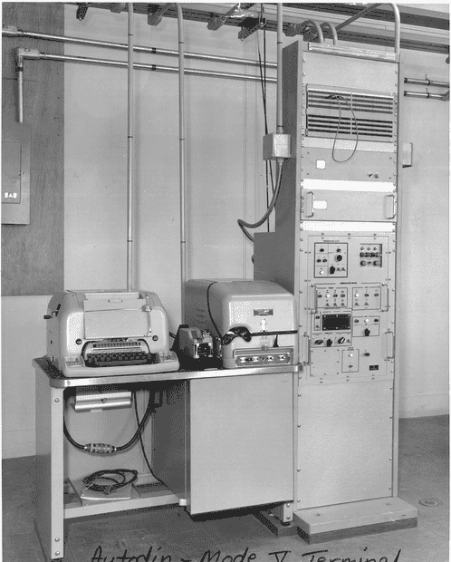

A pre-internet system called AUTODIN routed messages to several types of feeds (radio, satcom, avian carriers, smoke-signal...) using a precedence up to what's called Flash-Override for EAMS. There was actually a higher precedence level called CRITIC/ECP Emergency Command Precedence. Never saw it used even in testing. Most of us assumed it was reserved for Alien Attacks. :))
