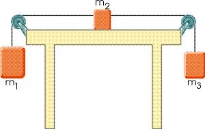

The table is rough and has a coefficient of kinetic friction of 0.395. The three masses are m1 = 3.69 kg, m2 = 1.34 kg, and m3 = 1.82 kg, and the pulleys are frictionless. Determine the magnitude of the acceleration of each block.
EF=ma
i set up force diagrams but i don't really know what I am suppose to find or how

thanks that helps but the forces that act on it are in m2: normal force, t1, t2, and the rate of gravity? m1&m3 : rate of gravity, and tension?
i tried to attach a copy of the picture
  • Diagram of three blocks on a table with pulleys at both ends: block m2 sits on the tabletop, block m1 hangs from a pulley at the left edge, and block m3 hangs from a pulley at the right edge, connected by cords.
I can't guess what the diagram looks like so until it is approved, try to do what you can.
Draw three free body diagrams, one for each mass. Write Newton's Second law for each of the diagrams. Note that the blocks have the same acceleration and that the tensions in the ropes are not equal. If they were, the block on the table would not accelerate. You will have three equations and three unknowns, the acceleration and the two tensions.
