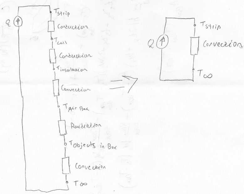

Now another question I have, representing a use case, of the nickel strip in a battery box without fans. Does natural convection still apply? Most battery boxes has holes for connectors, exposing the inside of the battery box to ambient air temperature. So it's not a completely enclosed space, but a very large percentage of it is.
  • #38
Yeah, but it becomes a system of transfers if the box is small. Heat is transferred from the conductor to the air contained in the enclosure, which is then conducted through the enclosure to the air surrounding the enclosure. This has the effect of raising the temperature of the conductor w.r.t to a conductor in a large “open” environment. Dimensions/thermal conductivity(new variables are obviously fine) for the material of the enclosure are needed to go anywhere with an analysis.
It’s a fairly straight forward extension of the problem when the systems are at steady state conditions because the power ##I^2 R## must be transferred across each boundary before it exits to the surroundings.

I don't know for sure. For starters, you get half the resistance. Did you double the surface area exposed to the fluid?
You are trying to solve too many problems at once. Focus on the task at hand. Find the temperature of the conductor in the box given constant averaged ##\bar{h}##, thermal conductivity of enclosure material ##k##, the box thickness ##\ell## and the surface area of the box ##A_{box}##.
At steady state there is no thermal energy accumulating in the system, hence the power ##I^2R## passes through each boundary without any of it being captured (if you will) by the stuff in between boundaries. Three of those are convection boundaries, and one of them a conduction boundary. Do you know how to find the steady state temperature of your conductor as a function of ##I##?

Once I narrow down the equation, I can consider the heat transfer of the box to ambient air.
For conduction, is the A term the area at which the nickel strip comes into contact with the box, or the whole surface area of the plane that comes into contact with the nickel strip? I guess I had just assumed it was the surface area of the stirp L*W that came into contact with the "bottom" of the box? But I'm not sure if it should be the surface area of the bottom of the box L_B * W_B?
I'm thinking that I don't know the temperature of the box. But can I come up with the heat transfer equation of the box, and assume that the number of watts transferred by the strip within the box, is also the same number of watts transferred by the box to the ambient air? I can then come up with a equation for the temperature within the box, maybe?

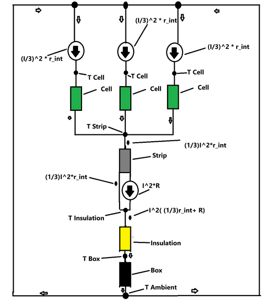

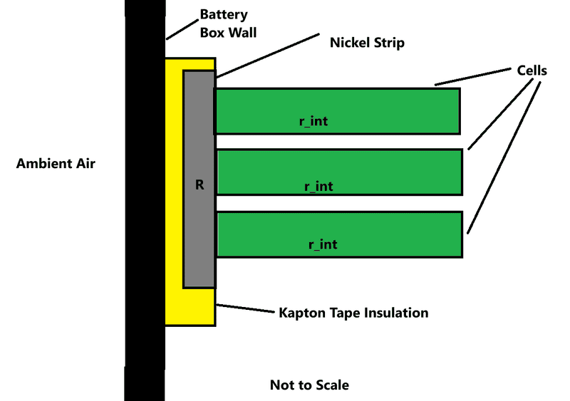

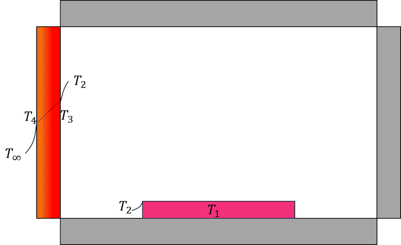

  • #42

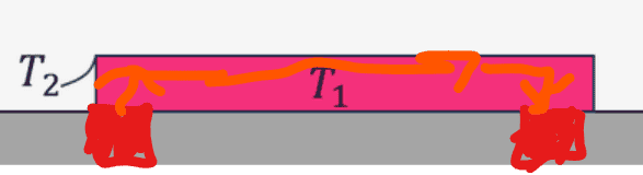

You have to make some decisions about how you are handling things in this scenario. How big is this box surrounding the conductor in comparison to the conductor?
  • #43
That's a great picture!
Thanks, I believe that there is to many unknown variables here?
I know the dimensions of the strip.
I know the ambient air temperature.
I can come up with a formula for the temperature of the strip.
Oh wait a second, the temperature of the air within the box is the same temperature of the strip ##T_{2}##? I was assuming that they would be different. But if they are the same. Than this might open some DOORS to calculating Convection of the battery box. I just want to be sure here that they are the same. Would defiantly make things easier.

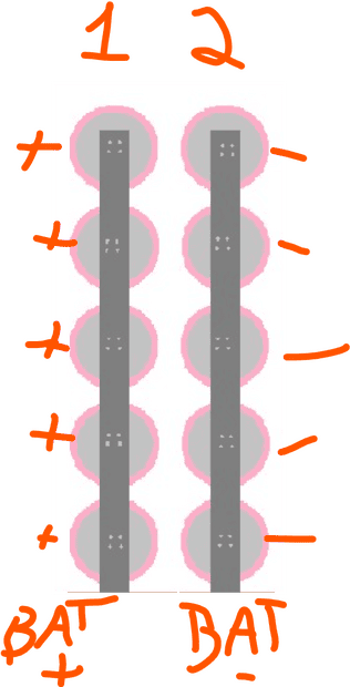

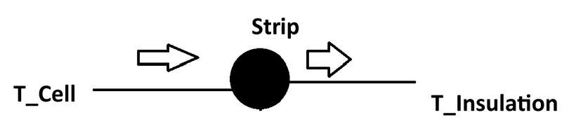

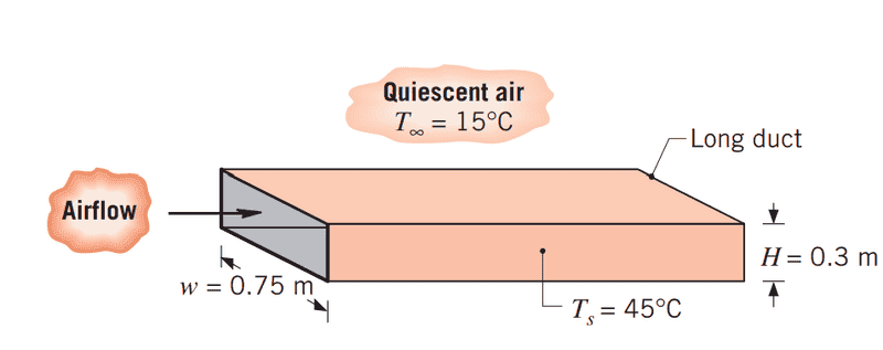

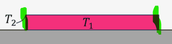

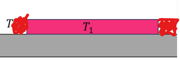

I was also wondering I know you had mentioned that the surface areas perpendicular to the flow of air should not be considered for convection calculations. Is there anyway you could elaborate as to why this is the case? This is very perplexing to me.
I understand in the example above of a long air duct, that the surface areas perpendicular to the flow of the air (i.e. both wxH or 0.75 mm x 0.3 mm surface areas) should not be considered in convection calculations, because the duct is open on both ends, so there's physically no material there, and is likely connected to some other duct.
However in the case of my nickel strip I have physical material there, the green highlighted portion below. For example it's not a hollow rectangular box.

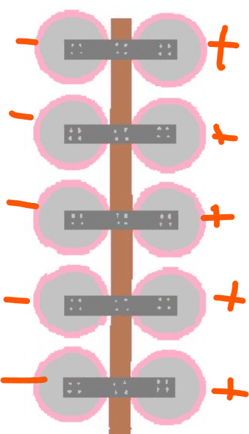

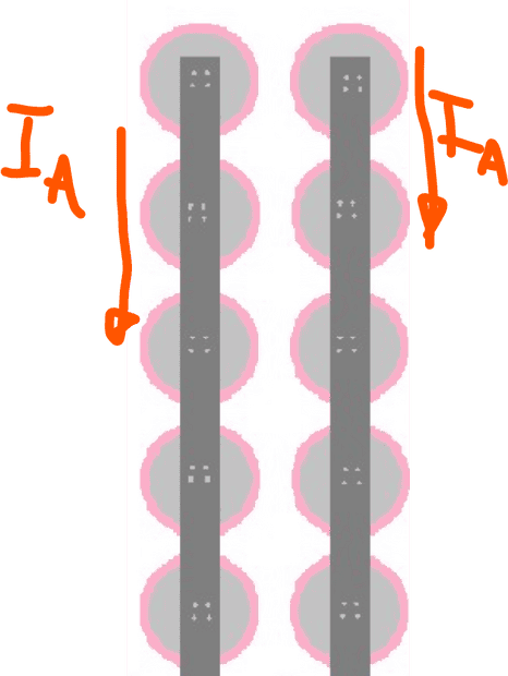

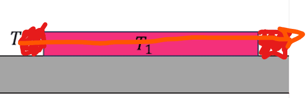

Nickel strips are commonly used in battery connections. Current still flows along the length of the strip, but it's more of like this
Case 1:
Where the red boxes are batteries or "the rest of the circuit". I'm not trying to perform this calculation or anything at this point with regards to "the rest of the circuit". Just trying to assess if the the two green surfaces should still not be considered in convection calculations if "the rest of the circuit" is connected in this way, as opposed to directly in contact with the two green surfaces (width times thickness) like below
Case 2:
Meaning that in both pictures with red boxes, where the red boxes represent "the rest of the circuit" and some other electrically conductive pieces, I do not consider the two green surfaces (length times thickness) in both situations? I can see in Case 2 I literally have some other item in full contact with the green surfaces, so therefore no convection occurs on these surfaces. But I'm unsure about Case 1.
I really do appreciate the help on this topic!

  • #44
Thanks!
No, They are different. ##T_1## is the ss temp of the strip. We neglect thermal gradients in this body because its a relatively thin metallic substance with a high thermal conductivity. We assume that everywhere in the strip is uniformly ##T_1##. There must be a temperature differential for heat to be transferred. Hence the surrounding air ( just outside of the convection boundary layer between it and the conductor ) in the box is ##T_2##.
Case 1: View attachment 356630
Case 2: View attachment 356632
It's about the boundary area. Imagine it is a thin film, heat is transferred across it, and in the direction of flow. We ignore this last part, that's why ##h## changes along the length. We are hand waiving that away. As for the open duct, the flow entering/exiting does not have a convection boundary with itself...it requires relative motion.
As for the green area, whatever you want to do with it. In the case of a solid conductor the flow which carries heat away would hit it...relative motion. BUT its a pretty tiny area, its most likely not worth the trouble of factoring it in unless you want to keep options open for geometry changes.
Its more accounting.
Note: You may have to scroll to the right to see the full post.
Thanks! I think it's getting a bit to complicated, with to many unknown variables, it will not be possible to calculate a current. I will try to represent this problem statement, with a current that can actually be found, along with simplifications, and why they can be made. If any of the simplifications are not required, please let me know.
Problem Statement
Evaluate the ampacity of an uninsulated nickel strip that is 0.1 mm thick ##t_{S}##, 10 mm wide ##W##, and 63 mm long ##L##. Additional details are intentionally not provided. This in alignment with current ratings of commercial cables that do not specify ambient air conditions, if the cable is within a container, or if additional insulation is placed around the cable. The orientation of the nickel strip is also not specified. Assume that it can be used in any orientation in outdoor conditions.

Kapton Tape Insulation Thermal Specifications:
Thermal conductivity ##k = 0.12 \frac{W}{m\;K}##.
Thickness ##t_{I} = 0.03 mm##
Lithium Ion Cell Thermal Specifications:
Thermal conductivity ##k = Unknown##
Thickness of 21700 cell ##t = 70 mm##
Thickness of 18650 cell ##t = 65 mm##

  1. Heat transfer via conduction from the temperature difference between the cells and the strip
  2. Heat transfer via conduction from the strip to the insulation from the temperature difference between the strip and the insulation
  3. Heat transfer via radiation from the temperature difference between the insulation and other electrical components within the box
  4. Heat transfer via convection from the temperature difference between the insulation and the air within the box
  5. Heat transfer via convection from the temperature difference between the air in the box and the air outside of the box
  6. Likely others that I'm forgetting...
We will consider the temperature of the cells, the temperature of the insulation, the temperature of the air within the box, all to be the same temperature as the strip. Hence, we will consider heat transfer via convection from the strip and the ambient air conditions.

Thought Question( conceptual): If you have two boxes of exterior dimension ##a,b,c,##. Inside each is an identical conductor generating ##I^2 R##. One box is made of thin conductive material, like 1mm steel plate( high thermal conductivity). The other is constructed of 18 cm thick plastic( low thermal conductivity). Both at a steady state, which has the conductor of greater temperature inside it?
  • #47
erobz said:
This is not correct. I think you are missing the forest from the trees. You must try to work with the overall process to understand what is going on. While the final transfer of power is that of convection, you can't just reduce it to that step to get the ss temp.
Thanks for the response and help!
I would say that the thick plastic box with low thermal conductivity would contain the higher temperature strip. This would be because convection wouldn't cool off the box as well, and heat would be more retained in the lower thermal conductivity.
So when I find ##\dot{Q}## for the nickel stirp, do I consider all heat transfer of the nickel strip and consider this to be one equation. Then find ##\dot{Q}## from the perspective of insulation as a second equation. Then find ##\dot{Q}## from the perspective of the battery box. Do I consider all heat transfers to be positive instead of negative? I'm thinking of something like this, from an electrical circuit perspective:
The heat transferred via convection from the cell to the strip is equal to heat transferred from the strip to the insulation. The whole thing of if you assume that current entering the node is positive, then current leaving the node is negative. The two are equal to each other
$$Q_{Conduction\;Cells\;to\;Strip} = Q_{Conduction\;Strip\;to\;Insulation}$$
Equation 1:
$$Q_{Conduction\;Cells\;to\;Strip} = Q_{Conduction\;Strip\;to\;Insulation} = I^{2}R$$
##Q_{Conduction\;Cells\;to\;Strip}## will likely not be able to determine. But I suppose if my assumption is correct, ##Q_{Conduction\;Strip\;to\;Insulation}## can be calculated, therefore I would know ##Q_{Conduction\;Cells\;to\;Strip}##.
Equation 2:
$$Q_{Conduction\;Strip\;to\;Insulation} = Q_{Convection\;Insulation\;to\;Air\;in\;Box}$$
Equation 3:
$$Q_{Convection\;Air\;in\;Box\;to\;Box} = Q_{Convection\;Box\;to\;Ambient\;Air}$$
Now showing each transfer as a function of the temperatures:
$$Q_{Conduction\;Strip\;to\;Insulation}(T_{Strip}, T_{Insulation\;1})$$
$$Q_{Convection\;Insulation\;to\;Air\;in\;Box}(T_{Insulation\;2}, T_{Air\;in\;Box})$$
$$Q_{Convection\;Air\;in\;Box\;to\;Box}(T_{Air\;in\;Box}, T_{Box\;1})$$
$$Q_{Convection\;Box\;to\;Ambient\;Air}(T_{Box\;2}, T_{infty})$$
Where the first temperature is hotter than the second temperature. Meaning ##T_{Box\;1} > T_{Box\;2}##
How to solve the problem:
  1. $$Q_{Conduction\;Strip\;to\;Insulation} = I^{2}R$$. Solve the equation for ##T_{Strip} - T_{Insulation\;1}## as a function of current. Lets call this function F1
  2. Solve $$Q_{Conduction\;Strip\;to\;Insulation} = Q_{Convection\;Insulation\;to\;Air\;in\;Box}$$ for ##T_{Insulation\;2} - T_{Air\;in\;Box}## as a function of ##T_{Strip} - T_{Insulation\;1}##. Lets call this function F2
  3. Solve $$Q_{Convection\;Air\;in\;Box\;to\;Box} = Q_{Convection\;Box\;to\;Ambient\;Air}$$ for ##T_{Box\;2} - T_{\infty}## as a function of ##T_{Insulation\;2} - T_{Air\;in\;Box}##. Lets call this function F3
  4. Insert function F2 into function F3. Now I have a function for ##T_{Box\;2} - T_{\infty}## as a function of ##T_{Strip} - T_{Insulation\;1}##. Lets call this function F4
  5. Insert Function F1 into function F4. Now I have a function for ##T_{Box\;2} - T_{\infty}## as a function of current. Lets call this function F5.
I think I'm getting closer in trying to understand how to solve this problem. But I would still have an unknown variable of the temperature of the outside of the battery box. I'm not seeing a way to solve for it.
I really do appreciate the help here with this! I'm wondering if I'm on the right track? Even if I disregarding the insulation, I would still have an issue of not knowing the temperature of the outside of the box, and I'm not seeing a way to find it.
Equation 1:
Equation 2:
Equation 3:
It’s late here, but here is something to chew on. You will apply surface energy balances working your way out or in. When you get to a wall/air boundary apply:
$$-k\left. \frac{dT}{dx}\right|_{x=0}= h(T-T_{\infty})$$
Then apply conduction to get through the wall to the next boundary temp,( x=0 just means evaluate the derivative at the boundary in question). Then to get across the convection boundary on that side re apply the equation above. I haven’t gone through this fully but I can’t see why we shouldn’t be able to find a solution for this.
P.S. correct, the conductor in the thick plastic box will have higher SS temp, all other things the same.

I see. Thanks for pointing this out! so I think it's something like this give, this guidance.
Using the image above, and ignoring any insulation, conduction from the bottom of the strip to the box.
Power generated in conductor equals heat transferred via natural of the strip to air within the box:
$$I_{A}^{2}R = (T_{1} - T{2})\sum_{n_{S} = 1}^{5} h_{n_{S}} * A_{n_{s}}$$
Solving for ##T_{1} - T{2}##
$$T_{1} - T_{2} = \frac{I_{A}^{2}R}{\sum_{n_{S} = 1}^{5} h_{n_{S}} * A_{n_{s}}}$$
Heat transferred via natural convection from the air in the box to the strip equals heat transferred from the air in the box, to the inner surface of the box via natural convection
$$(T_{1} - T_{2})\sum_{n_{S} = 1}^{5} h_{n_{S}} * A_{n_{s}} = (T_{2} - T_{3})\sum_{n_{B1} = 1}^{5} h_{n_{B1}} * A_{n_{B1}}$$
Plugging in the first equation into the equation above
$$I_{A}^{2}R = (T_{2} - T_{3})\sum_{n_{B1} = 1}^{5} h_{n_{B1}} * A_{n_{B1}}$$
Solving for ##T_{2} - T{3}##
$$T_{2} - T_{3} = \frac{I_{A}^{2}R}{\sum_{n_{B1} = 1}^{5} h_{n_{B1}} * A_{n_{B1}}}$$
Heat transferred via natural convection from the air in the box to the inner surface of the box via natural convection equals the heat transferred via conduction from the inner surface of the box to the outer surface of the box
$$(T_{2} - T_{3})\sum_{n_{B} = 1}^{5} h_{n_{B}} * A_{n_{B}} = (T_{3} - T_{4})\frac{k_{B}}{t_{B}}\sum_{n_{B2} = 1}^{5} A_{n_{B2}}$$
Plugging in the first equation to the equation above
$$I_{A}^{2}R = (T_{3} - T_{4})\frac{k_{B}}{t_{B}}\sum_{n_{B2} = 1}^{5} A_{n_{B2}}$$
Solving for ##T_{3} - T{4}##
$$T_{3} - T{4} = \frac{I_{A}^{2}R}{\frac{k_{B}}{t_{B}}\sum_{n_{B2} = 1}^{5} A_{n_{B2}}}$$
Heat transfer via conduction from the inner surface of the box to the outer surface of the box is equal to the heat transferred from the outer surface of the box to ambient temperature via natural convection
$$(T_{3} - T_{4})\frac{k_{B}}{t_{B}}\sum_{n_{B2} = 1}^{5} A_{n_{B2}} = (T_{4} - T_{\infty})\sum_{n_{B3} = 1}^{5} h_{n_{B3}} * A_{n_{B3}}$$
$$I_{A}^{2}R = (T_{4} - T_{\infty})\sum_{n_{B3} = 1}^{5} h_{n_{B3}} * A_{n_{B3}}$$
Solving for ##T_{4} - T_{\infty}##
$$T_{4} - T_{\infty} = \frac{I_{A}^{2}R}{\sum_{n_{B3} = 1}^{5} h_{n_{B3}} * A_{n_{B3}}}$$
Now
$$(T_{1} - T_{2}) + (T_{2} - T_{3}) + (T_{3} - T_{4}) + (T_{4} - T_{\infty})$$
$$T_{1} - T_{2} + T_{2} - T_{3} + T_{3} - T_{4} + T_{4} - T_{\infty} = T_{1} - T_{\infty}$$
Setting the two equations above equal to each other:
$$T_{1} - T_{\infty} = (T_{1} - T_{2}) + (T_{2} - T_{3}) + (T_{3} - T_{4}) + (T_{4} - T_{\infty})$$
Using the equations found for the temperature differences:
$$T_{1} - T_{\infty} = \frac{I_{A}^{2}R}{\sum_{n_{S} = 1}^{5} h_{n_{S}} * A_{n_{s}}} + \frac{I_{A}^{2}R}{\sum_{n_{B1} = 1}^{5} h_{n_{B1}} * A_{n_{B1}}} + \frac{I_{A}^{2}R}{\frac{k_{B}}{t_{B}}\sum_{n_{B2} = 1}^{5} A_{n_{B2}}} + \frac{I_{A}^{2}R}{\sum_{n_{B3} = 1}^{5} h_{n_{B3}} * A_{n_{B3}}}$$
$$T_{1} - T_{\infty} = I_{A}^{2}R(\frac{1}{\sum_{n_{S} = 1}^{5} h_{n_{S}} * A_{n_{s}}} + \frac{1}{\sum_{n_{B1} = 1}^{5} h_{n_{B1}} * A_{n_{B1}}} + \frac{1}{\frac{k_{B}}{t_{B}}\sum_{n_{B2} = 1}^{5} A_{n_{B2}}} + \frac{1}{\sum_{n_{B3} = 1}^{5} h_{n_{B3}} * A_{n_{B3}}})$$
$$I_{A}^{2}R = \frac{T_{1} - T_{\infty}}{\frac{1}{\sum_{n_{S} = 1}^{5} h_{n_{S}} * A_{n_{s}}} + \frac{1}{\sum_{n_{B1} = 1}^{5} h_{n_{B1}} * A_{n_{B1}}} + \frac{1}{\frac{k_{B}}{t_{B}}\sum_{n_{B2} = 1}^{5} A_{n_{B2}}} + \frac{1}{\sum_{n_{B3} = 1}^{5} h_{n_{B3}} * A_{n_{B3}}}}$$
$$I_{A}^{2} = \frac{T_{1} - T_{\infty}}{R(\frac{1}{\sum_{n_{S} = 1}^{5} h_{n_{S}} * A_{n_{s}}} + \frac{1}{\sum_{n_{B1} = 1}^{5} h_{n_{B1}} * A_{n_{B1}}} + \frac{1}{\frac{k_{B}}{t_{B}}\sum_{n_{B2} = 1}^{5} A_{n_{B2}}} + \frac{1}{\sum_{n_{B3} = 1}^{5} h_{n_{B3}} * A_{n_{B3}}})}$$
$$I_{A} = \sqrt{\frac{T_{1} - T_{\infty}}{R(\frac{1}{\sum_{n_{S} = 1}^{5} h_{n_{S}} * A_{n_{s}}} + \frac{1}{\sum_{n_{B1} = 1}^{5} h_{n_{B1}} * A_{n_{B1}}} + \frac{1}{\frac{k_{B}}{t_{B}}\sum_{n_{B2} = 1}^{5} A_{n_{B2}}} + \frac{1}{\sum_{n_{B3} = 1}^{5} h_{n_{B3}} * A_{n_{B3}}})}}$$
And Bingo was his name? It looks like if I did this correctly, I would in theory have everything I would need to calculate the current of a strip of given dimensions, provided a desired surface temperature of the strip, the temperature of the ambient air, the thickness of the box, the inner and outer dimensions of the box, and the thermal conductivity of the box?
I really appreciate the help with this!
  • #50
That all looks reasonable to me, good job!

Once conceptual question I have is shown in the example below:
Assume that the battery pack contains many nickel strips, connecting cells in series and parallel. The overall current used from the pack is ##I_{A}##. All series connections experience the full ##I_{A}## current. Items in series experience the same current. If the series connections are made up of more than one piece of nickel strip, but of same width and thickness connections, perhaps of different length, ##L_{1}## and ##L_{2}##, are in the same box discussed above. Each of the two strips see ##I_{A}##.
Now as far as the total heat transferred into the air within the box, do I need to consider the total volume of "all" strips experiencing ##I_{A}##, since each strip contributes to the overall heat transfer to air within the box, even though it's the same current ##I_{A}##? Meaning do the presence of additional separate nickel strips experiencing the same current, impact the overall current that can be handled by each individual separate strip?
One additional conceptual question I have, I see that ##h## is dependent on the orientation. But how is this impacted for my strip for the heat transferred from the strip to the air in the box? So say for example while my battery box is at rest on a table, the strip is perfectly perpendicular to the table and is considered vertical. If I rotate the entire box (and therefore the strip as well) so that it is now horizontal, from my perspective outside of the box, the strip is now horizontal. However from the perspective relative to the air within the box, the strip is still vertical and hasn't changed orientation, and I should still consider it as vertical? Meaning vertical and horizontal is from relative to what perspective? Maybe I'm just confusing this and making it more complicated. Certainly if I rotate a strip in ambient air from vertical to horizontal, the strip is now horizontal. But if I'm not considering open ambient air in the atmosphere, but air within a container, and the whole container and therefore the air within it rotates with the strip, I have a slightly different situation, and I'm not sure if I need to take into consideration perspective?

Your image shows two strips of batteries, each strip has the batteries in parallel.
Now, if the batteries are supplying (or consuming) a current, the current in the strip will vary along its length because each battery is sharing the current load.
Cheers,
Tom
  • #53
Cheers,
Tom
Sorry for not showing this properly.
One one side you have something like this. On the other something like shown in the other figure. Theoretical thought exercise only here to understand concepts:
Assume that the copper bus bar in the second figure is nickel. This gives me a 5P2S pack.
The second image shows that ##I_{A}## would get divided up amongst the total surface area of all the strips connected the positive connections to the negative connections, creating the series and parallel connections.
I see your point here though. At BAT + and BAT - I'm seeing the full current, however as you go down the length of the strip, you would be seeing ##I_{A}## drop off assuming each cell contribute equally, ##\frac{1}{5}##. I suppose you could vary the length, width and thickness somehow, maybe by "stacking" identical additional strips on top of each Strip 1 and Strip 2, to increase the thickness. I need to figure out how increasing the thickness impacts current carrying abilities.
