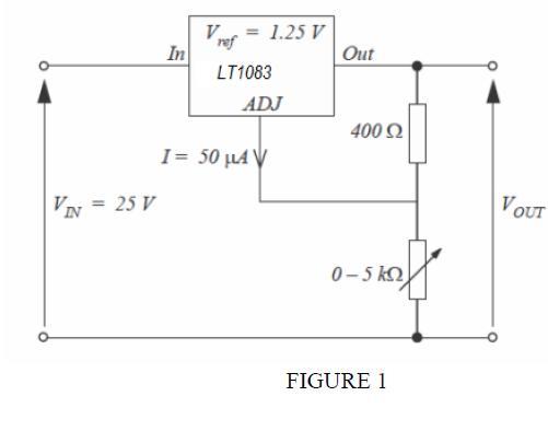

Calculate the output voltage range for the adjustable voltage regulator circuit shown in FIGURE 1.
I have read an older post and have understood how the formula works but I am thrown off by the inclusion of the 50uA current coming from the Adjust Pin. How would I cater for this current in the equation?
Reference https://www.physicsforums.com/threads/adjustable-voltage-regulator-output-voltage-range.864877/
##V_{OUT}=V_{REF}\times(1+ \frac{R_2}{R_1})##
  • Circuit schematic of an LT1083 adjustable regulator: input 25 V, Vref = 1.25 V, a 400 Ω fixed resistor and a 0 to 5 kΩ variable resistor to ground, with 50 µA shown flowing from the ADJ pin.

I messed up with the LaTeX there I apologise. Am I to ignore the vref of 1.25V in this circuit or does it have influence on the circuit? Thanks
I think Vref is the voltage at the junction of the voltage-divider resistors.
Vref is the voltage across the upper resistor, here 400Ω.
I've had a go at a solution how does this look?
Current through R2 =1.25/5000= 0.25mA
Current through R1 =1.25/400= 3.12mA
Then do I need to +50μA to R1 or R2 as well?

This isn't right. It's the upper resistor that has the fixed 1.25V across it, then its current goes through the lower resistor.
Add it into the current through the lower resistor. (Are you told that the 50uA is fixed for all outputs?)

The 400Ω has 1.25V on its lower end; what's the potential on its upper end?
1.25*(1+5000/400)=16.87V
That looks right, when the 50μA is ignored.
Now, can you recalculate taking into account that 50μA.

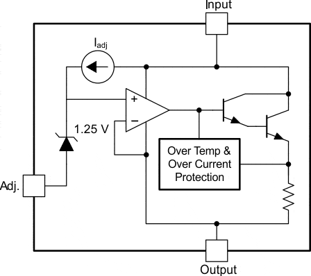

I may be wrong here, but that doesn't sound right to me. I thought the 1.25 V was the difference between the Output and the Adj. Since the regulator has no other ground reference, how can it know what the potential on the Adj is with respect to ground?
My thought for this problem was that there is a constant 1.25V across the 400Ω resistor. The minimum output is therefore trivial and the maximum output is when the other resistor is 5k and Adj is still at 1.25V below the output. Just a V=IR calculation.
Block diagram of an adjustable voltage regulator showing a 1.25 V reference between the Adj. terminal and a comparator, an Iadj current source, a pass transistor, and an Over Temp & Over Current Protection block, with Input and Output terminals.
This is the LM317. If you look at the lefthand comparator, I think it switches at 1.25V between Adj and Output.

8.4 Device Functional Modes
8.4.1 Normal Operation
The device OUTPUT pin will source current necessary to make OUTPUT pin 1.25 V greater than ADJUST terminal to provide output regulation.
You're definitely right. I'll go back and fix that.

If you look at the diagram of the LM317 adjustable regulator, you can see first that the 50μA arises because they use a zener with a 50μA constant current through it as the voltage reference. This zener current has to flow out of the Adj terminal to ground. Secondly there is a comparator (or op amp) which controls the output current to maintain the difference in voltage between the Adj terminal and Output terminal at 1.25 V
The 400Ω resistor is between Output and Adj, so there is always 1.25 V across it. So there is always 1.25 V / 400 Ω = 3.125 mA flowing in it.
The 5k variable also has this current flowing in it and another 50μA from the Adj terminal = 3.125 mA + 0.050 mA = 3.175 mA
Now you can calculate the voltage at Adj for any setting of the potentiometer, because these currents are fixed. And the voltage at the Output will always be 1.25V more than at Adj.
You ask how you can modify your formulae to take account of the zener current. I'm sure I could do that with a few minutes maths, but I wouldn't bother. IMO Once you understand what the IC does, you don't need formulae (unless you count the basic V=IR as a formula.)
Hi thanks for your patience so far which will probably run out after this:
Min Voltage V=IR 3.125*400=1.25V
Max Voltage V=IR 3.175*5000=15.875V
Yes, apart from the missing ##\require{color}\colorbox{yellow}{$\times10^{-3}$}## to make your equation correct!

I think you're still a bit low with your max voltage:
Rvar = resistance of variable resistor ...0 Ω....... 5kΩ
VAdj = Rvar x 3.175mA ......0Ω x 3.175mA= 0V ...5kx3.175mA = 15.875V
VOut = VAdj + 1.25V ......0V+1.25V=1.25V ....15.875 + 1.25 =17.125V
The Output is always 1.25 V above Adj.
