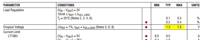

I've uploaded an image of the data sheet. The dropout voltage just states, "change in V REF=1%".
Those are the measurement conditions for the parameter. What you want to look at are any MIN, TYP, and MAX values for it:
So it looks like you need to maintain, worst case, a 1.5 V buffer between Vin and Vout.
Ah okay so the highest voltage of 15V still works just fine.
