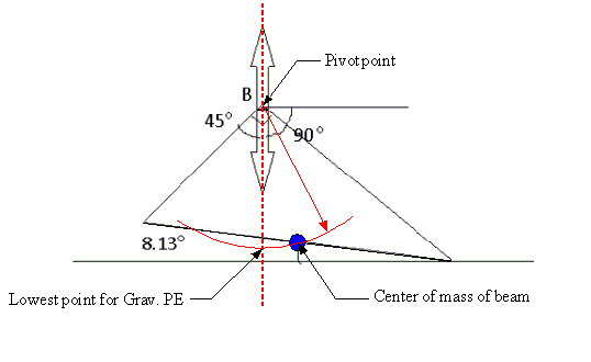

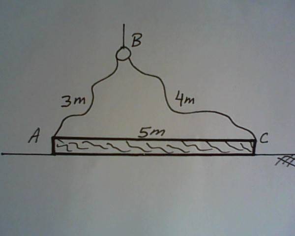

The discussion focuses on calculating the tension in two chains (AB and CB) lifting a 5m long uniform beam AC with a mass of 600kg. The chains have lengths of 3m and 4m respectively, forming a right triangle configuration (3-4-5 triangle) when the beam is lifted. Participants suggest using the Law of Cosines to determine the angles and recommend creating a free body diagram at point B to analyze the forces and solve for the tensions in the chains. The center of mass of the beam should ideally align directly below point B when lifted.
